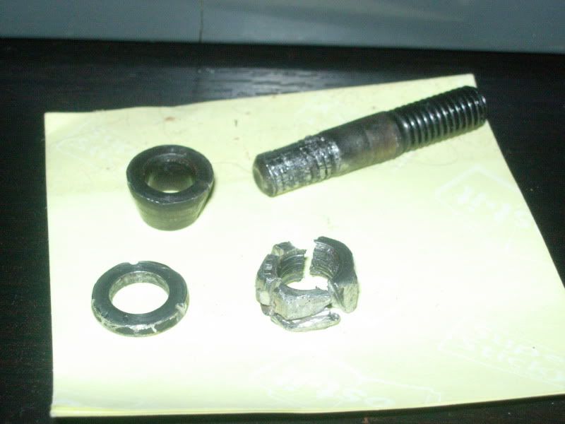

Well, after doing a torque check after a week or so of driving, I ended up with this:
The new stud will be in on friday.

That looks like a stud from the front hub.:Wow1:
I hope that fix goes without trouble.
On my old 4Runner (Misty's rig now), those cones were so tight, I never got them off. I didn't take that rig swimming in the rivers, so it never seemed to need the front bearings re-packed.
Fergie
That is exactly what it is.
Dave is awesome though and had me a new part by today.
I think the PO put the wrong size nut(13mm OD instead of the 12mm like everything else) and when we torqued it properly, the thing stipped out.
