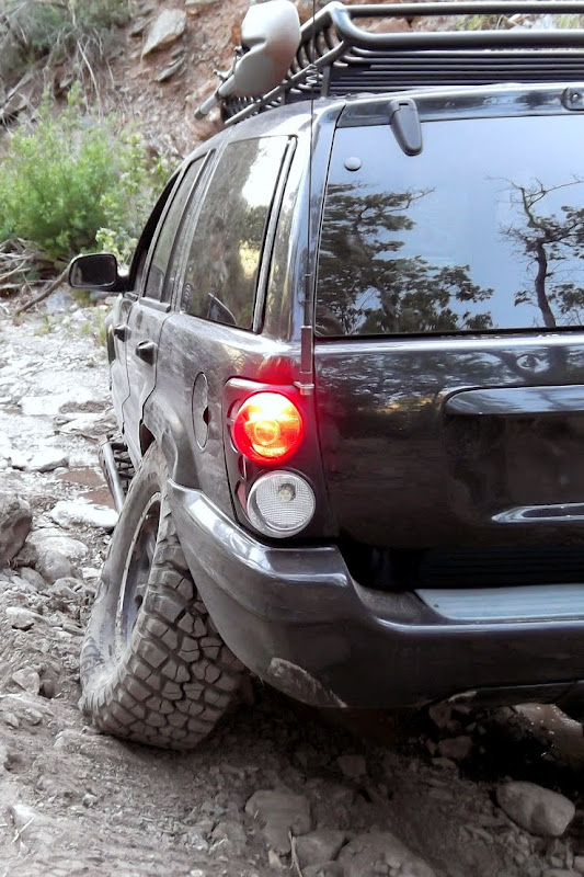

some shots by dzJeepChic:
big ***** rattler ..as always cool pics ..was that your broken shock mount?
yeah it ripped off while exploring a recently re-opened local trail! i'm not even sure which boulder took it out, someone noticed it while spotting me but didn't see it happen. then we went to remove the shock and the upper bolt broke off inside the frame rail! i still have to get that out and fix the mount :(
