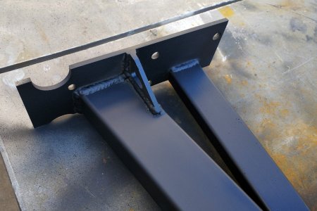

Time to work on the rear quarters. I'm going to trim the bottoms off and run a slider like on the rockers. It will run down the side and then turn back to the frame rails. It will be a detachable corner that bolts onto the right and left corner of the truck.

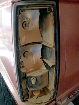

While taking off the tail lights I figured out why the bulbs were so dim. I mentioned the previous owner lived down a dirt road.

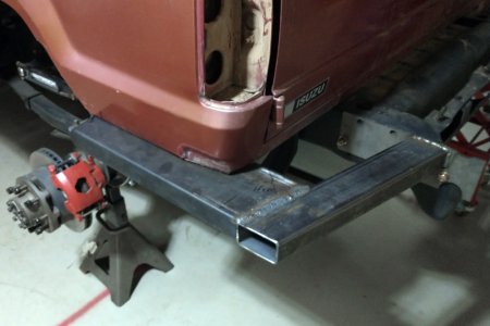

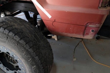

OK, enough head scratching. I had to dive in today and start cutting. I had some success and other shortcomings. I know what to do on the other side. It's going to take a couple days to get this done, then I can get to work on the exocage.

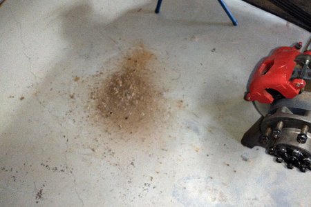

Of course I got another pile of dirt on the floor from inside the rocker. I guess I'm working on old iron because the iron in the soil around her gives it the red hue.

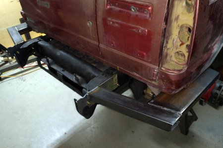

More work on the rear bumper, corner mods. There's no instruction manual; just try stuff and figure it out. I really didn't have a design in mind, just going with that's there. I'll cap that end. I will have a full size spare tire and two jerry cans mounted to a swing out carrier so it has to be beefy. It will be riding on the frame. Yes, that's the blazer 31 gallon fuel tank poking out. The rear hitch hangs down very low. I'm going to tuck it up 2 inches higher so I don't have an arrestor hook on the back end.

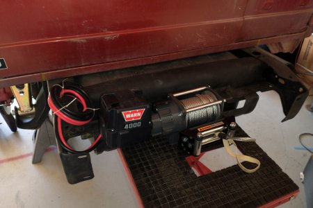

I'm having to think 2 or 3 steps ahead as I go. Why would I mount only a 4K winch on the back? To lift my spare tire onto the carrier. Also thinking of other ways to use it. I could design the tire carrier to be like a crane. It would lift a bike too. Got any other ideas?
