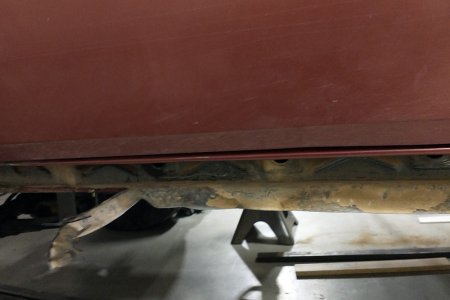

I took a few days off because it was cold. When I got back to work I thought I had both the sliders done. That's when I discovered my head was up my azz. The second one I built was 4 inches too short. :ROFLMAO: It's not the end of the world. I can use it for the rear section behind each tire. I then had to build one more. I knocked it out pretty quick, but it's not identical to the other side. You can't stand on both sides at the same time so...

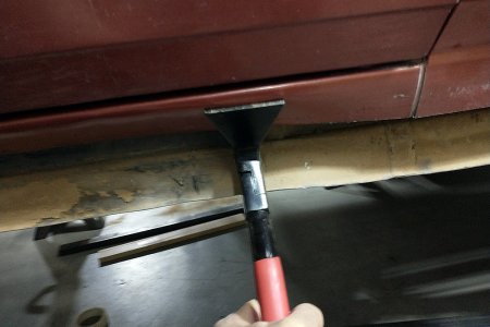

I also figured out a great way to clean up the rocker cut. I just wish I had figured it out sooner. I ordered some flanging pliers. Using the body line at the bottom of the door opening I bent the sheet metal over along that edge. It worked great so I purposely left the driver's side long when I cut it. After bending it over it leaves a real nice rolled edge that's double walled. I might even be able to weld it now.
I gave it a bend and then persuaded it with a heavy hammer. Looks nice and so easy.

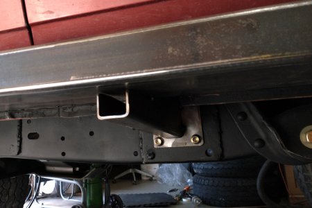

Here is the construction I am doing. The base plate will be welded to the frame to spread the load out. The smaller plate will be bolted to the reinforced plates on the frame. Then the 3x2, .120 wall leg will run out to the rock sliders. There will be three legs. The body will be attached to the rock sliders so the body and sliders will be mounted directly to the frame, no body mounts.
Here you can see the plate bolted to the frame. If you notice the yellow paint lines on the top of the frame. That's the one inch I moved the body forward. I painted the frame under the plates with steel-it so it doesn't rust. I can weld through it, it's designed for that. You might also see the 5th bolt head. I was originally going to do rosebud welds on all the existing holes in the base plate but this hole just happened to line up with an existing hole in the frame, so I used it to align the plate before drilling the holes in the frame. The same hole existed on the other side. Ironically, it was the same for the rear mount. It had existing holes that lined up on both sides too. It makes it so much easier not having a floor in the body. Access is great!

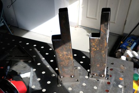

I made a couple legs for the sliders, but didn't like them, so I made new ones. These will go under them to give more support. I cut them out like puzzle pieces so I could use less material. Then I tacked them together and did some clean up grinding. That's a good way to make stuff when you are building several. Tack them together so you make two at the same time. The front two are flat, the rear two are at a 5 degree angle because the frame dips down there.
I have the legs tacked together and they will hold the slider up in place.

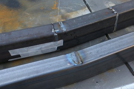

I'll take a pie slice out of the end and bend it up to cap the ends. It will have a third leg, but I'm going to do a bunch of work I need to do first before I build that one. I'll build that one in place after I'm pretty confident I won't be lifting the body off. Now I can start on the exo cage. The plans I have are kind of wild.

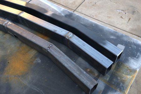

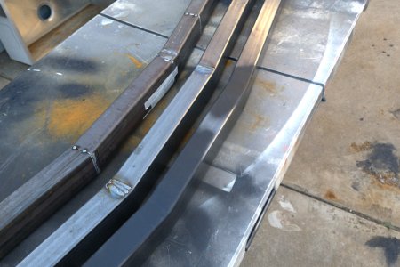

I tacked together a bunch of scrap to prototype the first leg of the exoskeleton. On the bottom kink I cut angles and butted it together. On the upper kink I made pie cuts with the chop saw and bent it over. Two pie cuts got me 10 degrees of bend. I'm going to use this method as it's super easy and leaves the outside edge totally smooth and uninterrupted. No reason to add my ugly welds if not needed. Notice it lines up with the body mount. What does everyone think of the rectangular tube? I think it's going to go well with all the square, straight lines on the body.

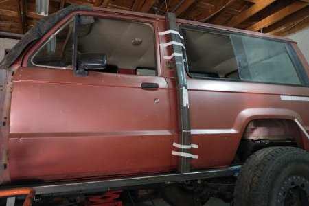

Once I figured out the pie cut technique I made a passenger and driver side bar in a little over an hour. Now I need to make two more for the rear. It's another round of mental gymnastics to weld it all together in an order where I can get the back sides of everything. It fits very tight to the body. Feels good to make progress.
