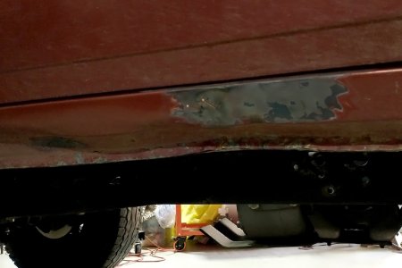

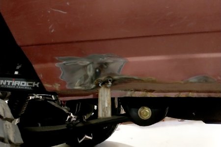

I have the body temporarily bolted to the frame. Next on the list is rock sliders. I'm going to be doing the 2x6 rectangular versions. They would fit up against the pinch seam and under the rocker panel, but the passenger side is hammered. In off road racing, the damage ends up mostly on the passenger side due to the driver's self preservation. This rocker was hit multiple times. I wouldn't want to ride with the P.O. I've been trying to pull them out, but it needs a frame machine clamped to the pinch rail. I tried with a BFH, but it didn't budge. Since I need to cut the one side rocker off, I'm going to cut both sides and tuck them up into the body. A lot more work and the one side will probably still be mangled. I learned in restoration, always get the metal back in place before you cut anything. I won't be able to do that. Not too happy about it, but that's the breaks when you're a garage builder.

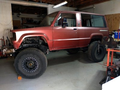

I put the 37's on. She's going to be a rowdy girl.

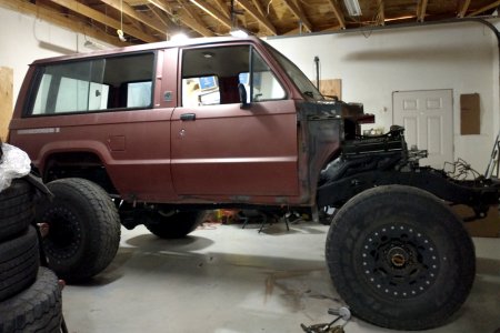

I'm very pleased how well the body fits on the chassis. So many little projects all going on at once. One more hurdle will be the radiator and ac condenser mounting. The wheelbase works, but the Blazer chassis is much longer than the trooper. It's going to be tight if I run the Trooper front end and fenders.
