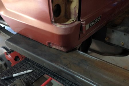

Time to work on the rear quarters. I'm going to trim the bottoms off and run a slider like on the rockers. It will run down the side and then turn back to the frame rails. It will be a detachable corner that bolts onto the right and left corner of the truck.

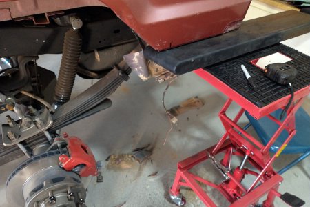

OK, enough head scratching. I had to dive in today and start cutting. I had some success and other shortcomings. I know what to do on the other side. It's going to take a couple days to get this done, then I can get to work on the exocage.
