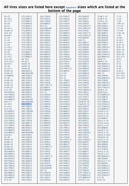

SIZES
Just received a full set of RUD Grip 4X4 chains for my 285/75/r16 tires. I am rather impressed by the quality. They're lighter and a bit more compact than I had thought they would be. They also come in a nice carry case for each set (per axle)...something else I hadn't counted on.
