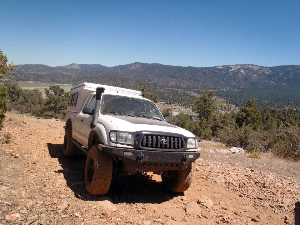

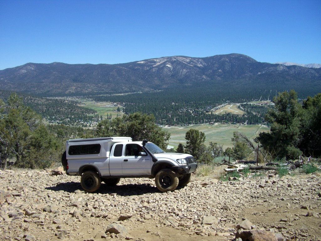

I often only put up pictures of mods in here and forget to add trips and events, so here are some from last weekends trip to Big Bear.
4RunAmok
What a great trip, and all of us did really well on the trails... No winching, and no damage... And that's saying quite a bit being that we had a STOCK Tacoma in our group with only light trail goodyears on it!

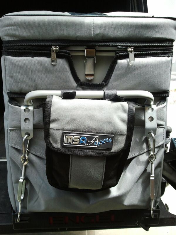

While we're on the topic of the fridge being in place. I added a goodie from Slee Off-Road.
I wasn't real happy with the factory fridge tie-downs included with the slide. The nylon straps couldn't be tightened easily and always had a bit of slack. The Slee fridge tie-down brackets are designed to attach using the same screw location as the factory handles. Longer stainless steel hardware is included for the extra width of the brackets. They provide a solid mount for use of turnbuckles to securely anchor the fridge.
