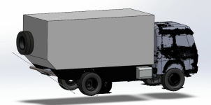

And it's a bit overdue but the CAD model has finally been started, including a pretty poor quality 3D scan performed by my drone...
