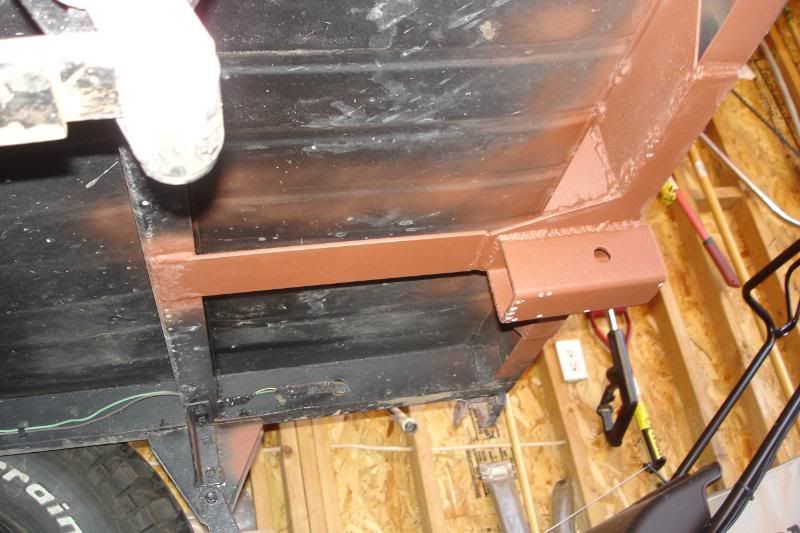

Hitch!!
I have been wanting to weld in a hitch for the longest time!....Well...got some time from school....
All primed up! Needs a coat of black....
Note to self.....I hate overhead welding!!!.....My welds always suck!...If i had more time and a helper....I would have used my bridge crane to hoist the trailer in the air....oh well...:ylsmoke:
I'm going to be doing some testing with this hitch setup....My trailer box is welded to the frame....most boxs i have seen are bolted to the frame...
I might need to add some steel strapping like a "V" style on the middle channel.....
In my opinion...I would not pull extremely hard in a recovery situation with the tow rig.....The frame seems to be pretty light to me...
The hitch is going to be used for a bike rack and for light recovery.

Be carefull how much weight you put on the back hitch unless you add an equal amount up front also - otherwise you'll have the tail wagging the dog if you know what I mean.LOL

Hey Nic, looking good... Bummer because we have an overhead chain hoist that could have done the trick.. Looks good though, agreed the frames are a little chincy but that will be fine for almost all recoveries and as much towing as that trailer could handle IMO, looks strong :) Also really good reading about your brakes, has me thinking... :sombrero:
