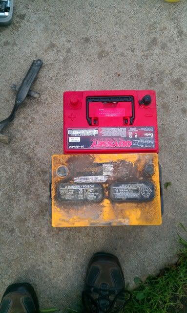

So I got the tray and batteries installed. Out with the old and in with the new :victory: I outlasted the Duralast. But in all actuality it was a great battery and lived up to the abuse but for my power needs I though it was finally time to go with some deep cycle batteries.
Currently I run: ARB Fridge, Rock Lights, HIDs, CB/PA, Laptop, Solar, DVD Navigation + Sub, and my 12,000 winch. I plan to also run several other items in to future....

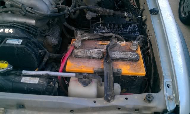

Old:
Side by side:

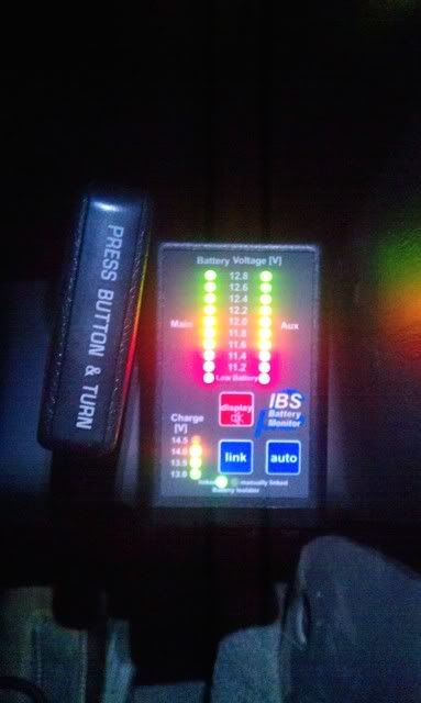

I just completed installing the IBS I received from Moody (great seller!) and my truck never caught on fire! :1888fbbd: Everything seems to be working great and both batteries appear to be fully charged.

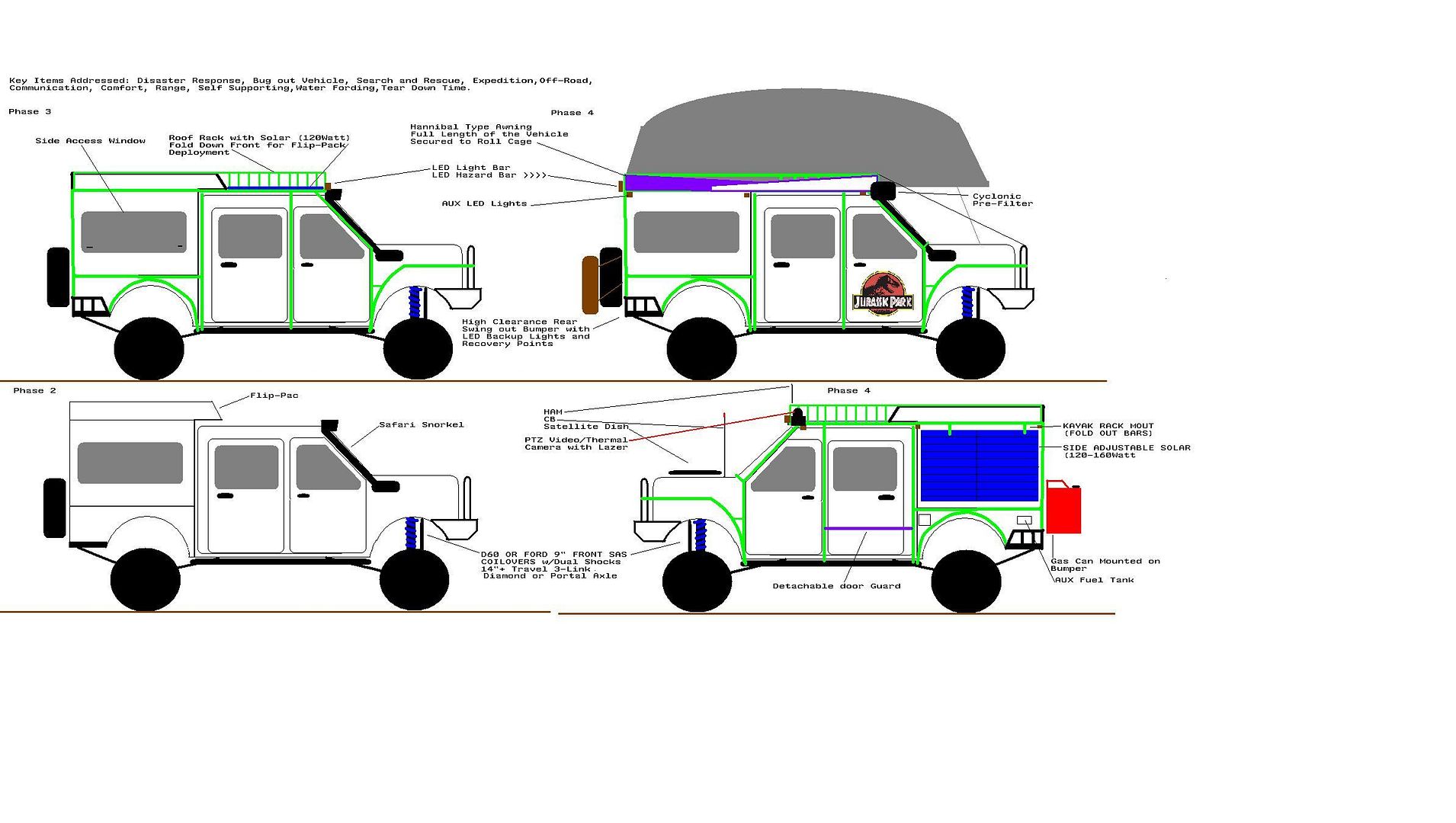

On another note, this is what can happen when you have too much time. Here is my eventual blueprint design.
