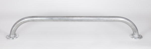

Something to steady us with. We wanted a handrail and I REALY WANTED one that did not look like the typical RV handrail. Marine store to the rescue.
I used a 3/4" aluminum rod, NOT all the way through, just to the inner FRP panel with foam removed to stop wall compression when I tightened the screws. I could have used a wooden dowel. I used birch plywood backing plates, to cut down on thermal transfer. TEST FIT, I will get it powder coated black and sealed in place in the next few weeks. I left the aluminum rod .025 proud for a place for sealant to live :)
