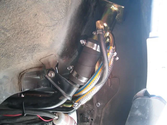

It sounds like you are going with a transfer system. I don't know exactly how your OEM filler looks like but this is how mine is set-up.
The black hose with the fuel filter on it is coming from the Aux tank and behind the fender is the aux fuel pump. The small 1/4" black line at the top of the filler neck is coming from the fuel pump and feeds the main tank filler. As you can see, when the main tank reaches full, the fuel just pours over back into the aux tank filler (rear one). The clear hoses are just the breather for both tanks.
attachment.php
Yes, I'm going with a transfer system. Not being the brightest bulb on the tree I thought KISS would be the best way.
The in-line filter is a great idea. I was going to avoid removing the sending unit and internal pump if possible and who know what kind of crud is in the tank without inspecting it? A filter could prevent a lot of heartburn down the road.
As I mention the tank has and internal pump so no Aux pump to deal with.
I will also have a factory dual filler neck, I haven't seen it yet. The drawings don't look like there is a place to connect a hose from the pump. Did yours come with the pump connection or was it something you added?
Mine came with the bung for the fuel feed. My filler is not OEM but I might be picking up an OEM one for the restrictor. Please post a picture of yours when you get it.
