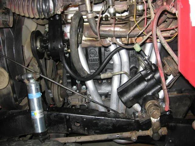

do you want push pull steering or cross over? An '85 will have a solid front axle and push pull box (just like an '85 4 runner in the states only on the other side!) once you get into '90 and up they are IFS and will have the box that alot of mini truck owners use for cross over steering (but RHD of course!)
just to make sure you get the right one
The stock Land Cruiser steering is a push/pull design. With a 79-85 solid axle box, I can replace the original manual box with a ps one....and keep the original steering, shock tower, etc.
Like this, only on the other side:
attachment.php
I'll replace the tie rods, and rebuild the center arm, so steering should be pretty tight, and close to stock for the OEM factor....
-H-
I know a lot of folks use the cross over style 60 series or saginaw conversion, which is supposed to be better for 35"+ tires, lockers etc., but my steering is pretty good right now, so I think the "simple" ps upgrade will be the best option....
