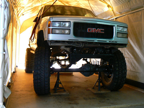

Tires and wheels will be the last thing I do. Still lots of work to do. I've been taking care of a few odds and ends like:
1. Death Wobble. It was bad. Turns out the king pins just needed some shims. All better now.
2. Inspection. Amazingly it passed inspection except for one thing. They wanted a high-beam indicator, so there is now a shiny new blue light on the switch panel.
3. Couple oil leaks on the turbo, installed better hose clamps on the intercooler hoses. The other ones kept bustin' loose.
4. Sealed the transfer case shifter boot after a water crossing caused muddy water to flood into the cab.
5. Installed latches on the rear swingouts so that it can be locked open.
6. Got the AC working! A must have in Texas during the summer.
Still a couple problems to fix:
1. It really needs a steering stabilizer. Looking at getting dual Bilsteins.
2. Besides the need for a stabilizer there are some strange gremlins in the steering. The steering wheel cocks to the right.
3. Gauges are dying on me right and left. The voltmeter and the pyro are non-functioning as of two days ago. The tach has displayed some weird fluttering. I had my mechanic look at the tach and he couldn't find anything wrong. Maybe there is a wiring problem. Or maybe I got a bad batch of autometer gauges. The latter seems unlikely, but stranger things have happened.
Then there is the long to-do list for the interior. I figure October for it to be finally done? I'm taking it on a few smaller trips to test things out this summer. Going to my friends ranch this weekend and going to the coast in a couple weeks.
