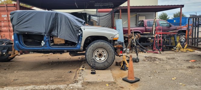

My sons baseball season ended so we will have more time to get stuff done on the truck. We had a little free time and he was itching to do something so we got the passenger side coil bucket swapped out. We were also able to hack together a temporary steering shaft coupling the Dakota column to the Superduty steering box. We also ordered up some new body mount bushings so we can get the cab mounts moved and finalized. We also we played a little with Ai to get a idea of what the exterior color would look like on the truck. this color is a battleship gray that matches pretty well what he is looking for.

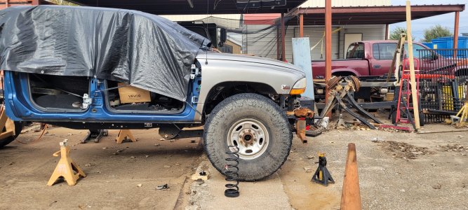

Been slow going with family but was able to get a little done. I adjusted front axle in the wheel opening because at full bump the wheel was a little far forward. With the wheel past full bump there is no rubbing from lock to lock except right at lock where the rear inside of the tire rubs the radius arm.

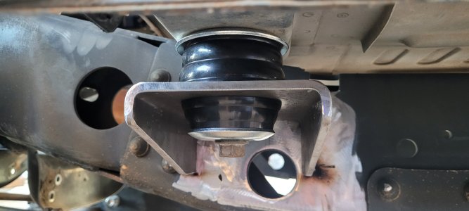

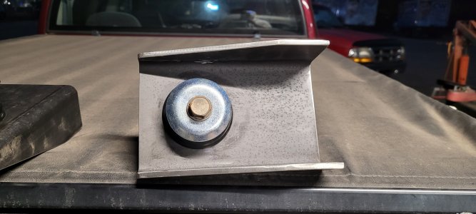

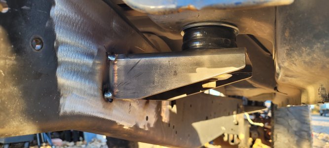

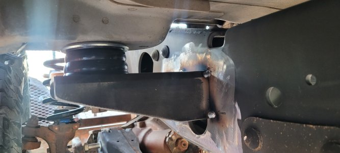

After the cab location was set I cut the frame cab mounts off and built new mounts out of 5"X3" 1/4 wall rectangle tubing. I drilled out the hole for the body mounts and then cut the profile for the mount. We are trying to keep the ride height as low as possible so I set the cab as low as I could without worrying about rubbing when flexed. Next step is for my son to weld in the cab mount, after they are on solid we will be chopping the front of the frame rail. We need to do this to make the frame line up with the core support mounts.
