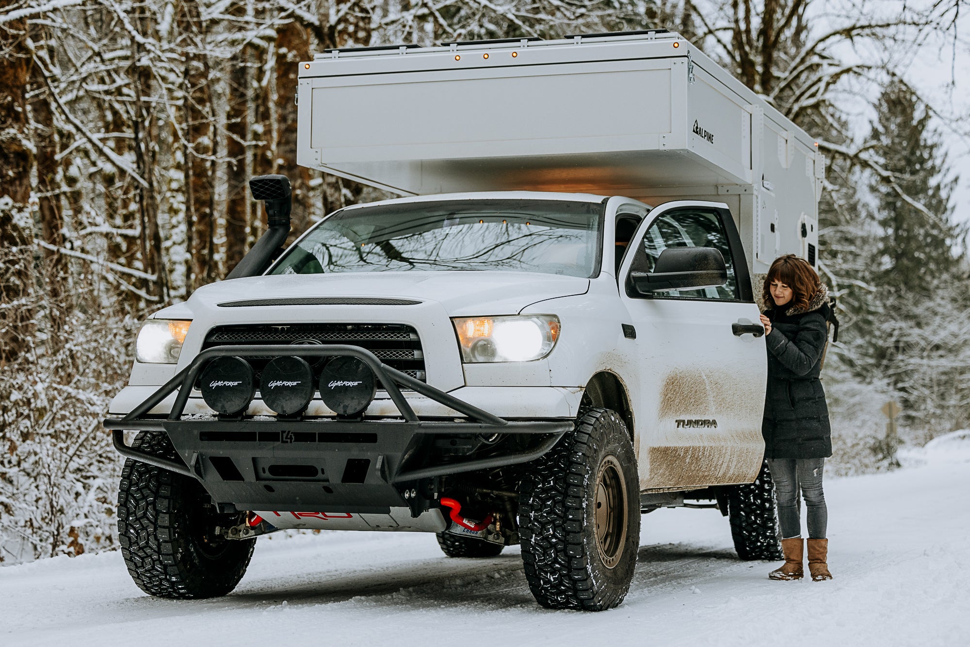

Btw. The Geordanos on desk to glory and are currently travelling across the pond in Europe have a gen 2 Canadian Tundra with Scheel Mann seats. I think they have a write up on thier web page, or at least somewhere, about the conversion. https://www.desktoglory.com/
