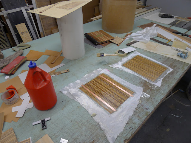

(above) Last weekend I started the covers for the book that will be a journal of the Jeeps transformation...Most of the materials for the covers is knife cut and everyday I sharpen the knives and chisel with a few passes on 220 grit sandpaper...Doing it everyday leads to super fine edges that are close to scalpel sharp...
(above) The covers are mostly zebrawood veneer with copper and afromosia accents...The covers are veneer stuck to veneer and fiberglassed in and out...The spine of the binder will be leather and look like the finished book in the background...Mike will print up the pages then I can bind it to my work...

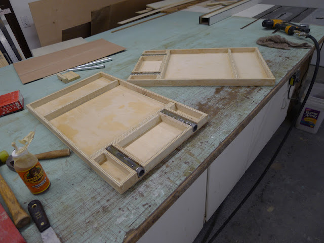

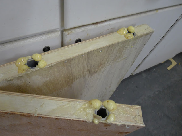

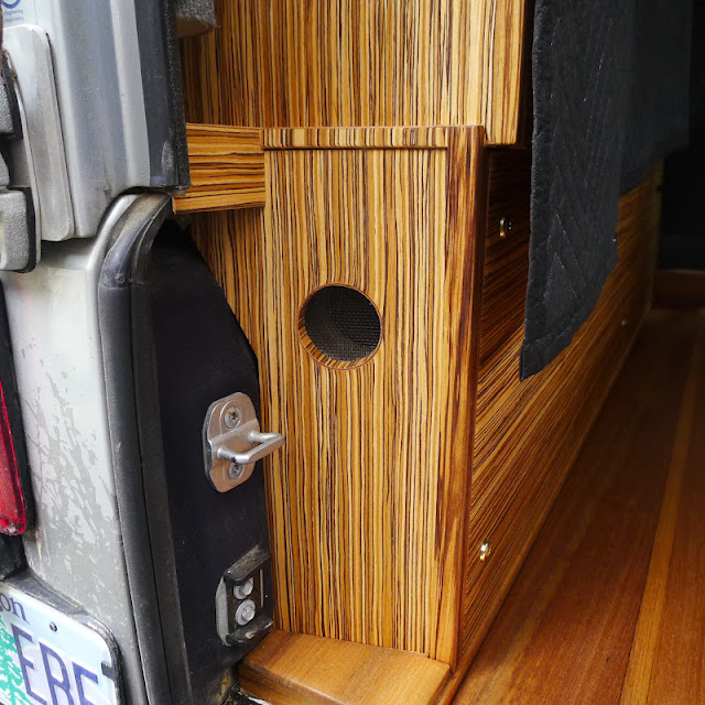

(above) Back to The Project...The backrests for the bench seat still needed to be built...This is a look inside the back rests before the outer ply goes on...The pipe sleeves are where the dowels that will join the right and left sides fit...The pipes were covered with a liquid polyurethane glue to keep them firmly in place...I wet all the contact surfaces to help the glue expand and fill the cavity...
(above) An hour later...
After the glue was scraped and the panels were sanded, they along with a 1/4" plywood pattern for the bench seat, were taken to the upholsterer...

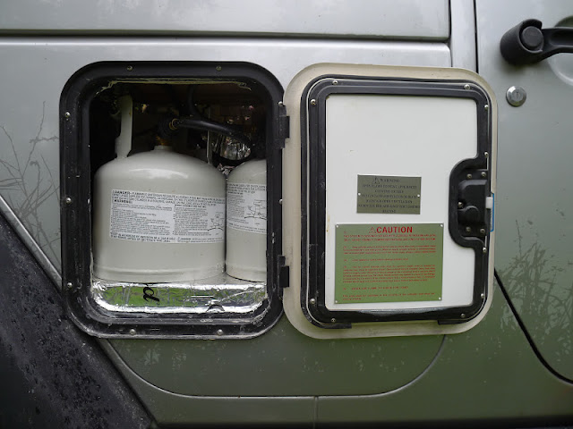

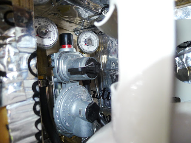

(above) The propane locker is 100% done, so here's a few pictures...
(above) The propane caution labels on the door are new...The top of the fiberglass hatch frame were cut back to let the tanks go in straight without having to puzzle fit them in...The locker could not be 1 cm. smaller and have both tanks fit...I think it is amazing that twin 4# tanks fit in there...
(above) The regulators and pressure gauges...

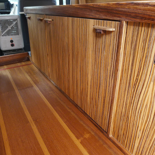

(above) I have progressively finer wet sanded with tung oil the woodwork and the time spent doing it show...I am pleasantly surprised on the richness of the grain and the colors...In person, it looks even better...
(above) The floor was sequentially sanded and oiled...More wet sanding with oil will happen, I'll take it to 320 grit before I'm done...

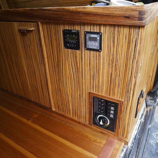

(above) These monitors are hooked up now...

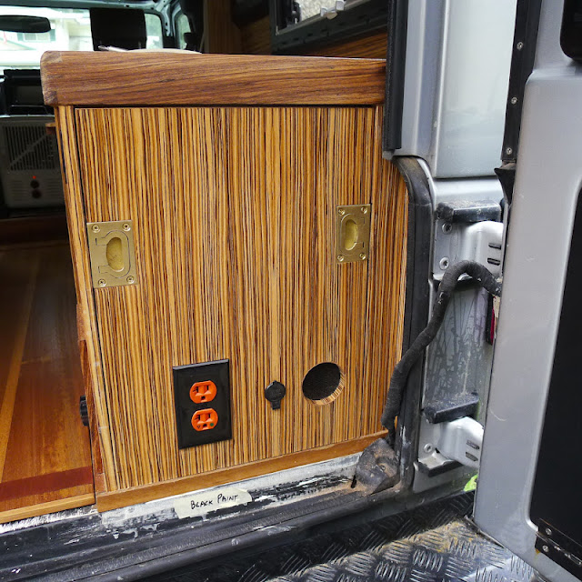

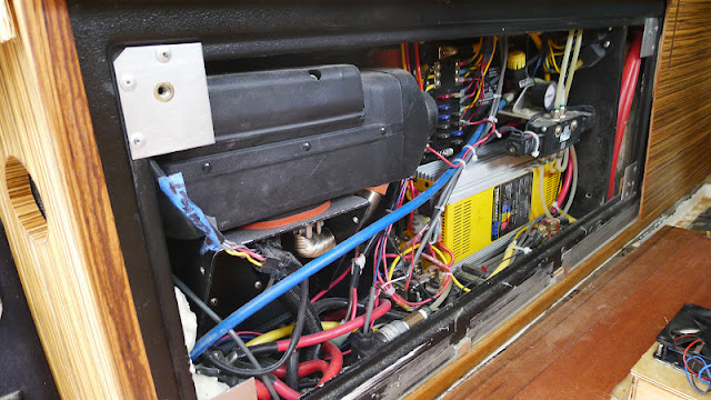

(above) The inverter behind this panel was connected and it works now...The bench edge is only sanded to 100 grit so that needs more sanding and oiling...I'll paint the floor below the cabinetry black before I'm done...

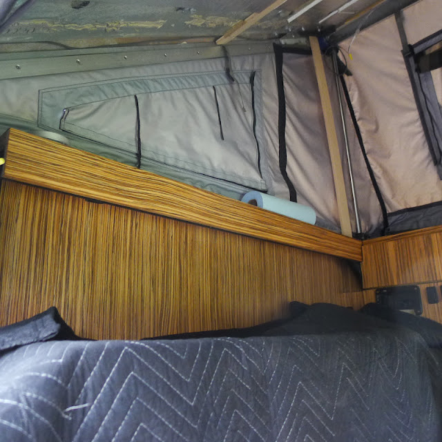

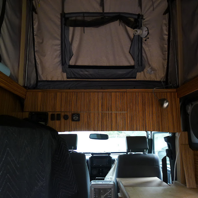

(above) Above the driver side cabinet looks like this...Not much changed...
(above) Up front the bed pull-out panel got another piece of trim at the top to create an even line between the side pieces of wood...A step would have been distracting and i want this space to look smooth...The gauges and monitors still need to be finalized...

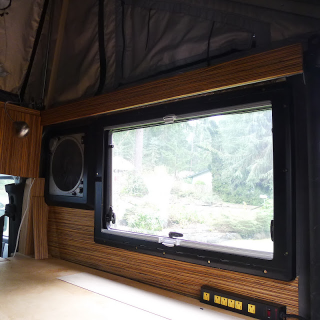

(above) Curb side...That power strip will be mounted vertically on the wall to the rear of the window...

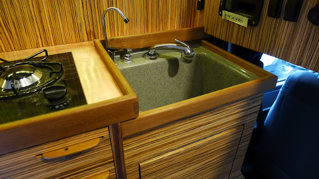

(above) The sink edge has been sanded and oiled...The grey sink looks fine now...Before it stood out starkly, but now it seems like it was part of the original plan...The burner is hooked up now too...

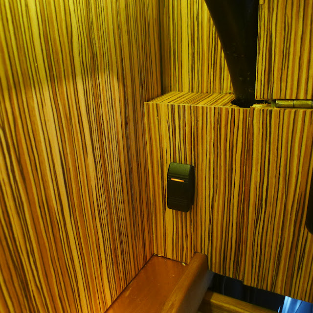

(above) Behind the sink, to the right is the switch for the under the roll bar lights...I finished off the space above it with scraps...

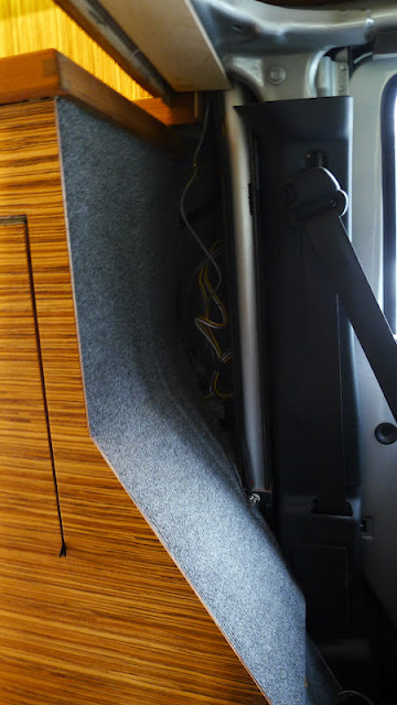

(above) Below that, behind the driver seat got some grey carpet...Before I'm done, those wires will be hidden...

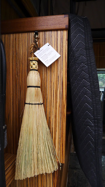

(above) A few weeks back while in Vancouver B.C., I found this...
(above) So I put this here...
(above) ...and put this here...
These are hand-made at the store there in B.C...Very cool watching them be made by a woman with very strong hands and a very Canadian accent...

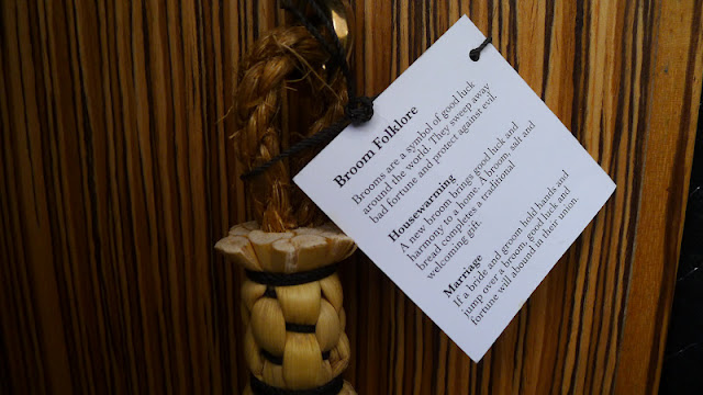

(above) My housewarming gift...It will be interesting to gauge the use the Jeep gets by the shortening of the broom...Sort of an analog odometer...
(above) Down here I closed the breaker to activate the entire electrical system...No smoke and sparks...But the heater fan kept running so I pulled that fuse...Grrrrr...Later....

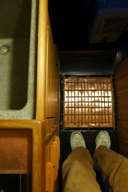

(above) The subfloor...Mike came up and over lunch explained to me why the indoor shower is important, and I'm with him on that now...Before I was dubious...So I enthusiastically went to work on finishing that...

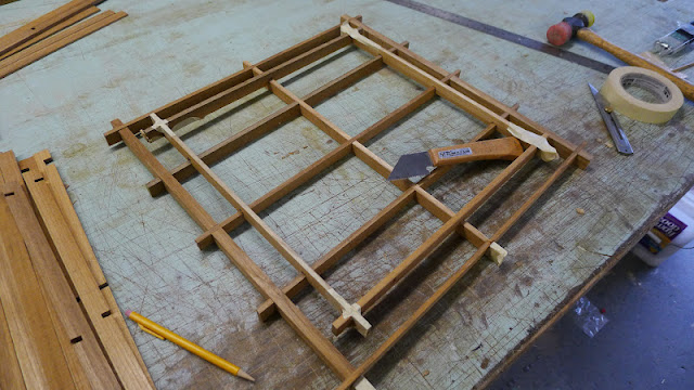

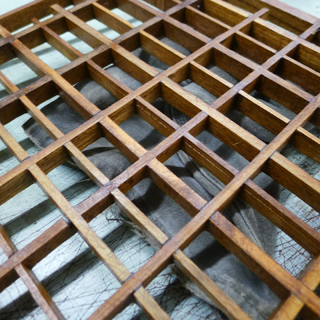

(above) I had a bit of teak scrap lying around so I cut it pretty much to all the same size and using half-lap joints started building this shower floor duckboard...Note the saw...It is a cheapo from Harbor Freight that had severely dulled and broken teeth up front that I tin-snipped to this size...It is perfect at that length for detail work like this...
(above) And when the scraps were gone, I had this...

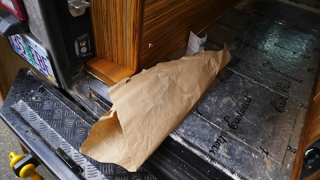

(above) I picked up this black rubber carpet runner stuff and will use it over the silver insul-mat and glue it down when I finish off the subfloor shower zone...It's all super loose in the picture, but you get the idea...

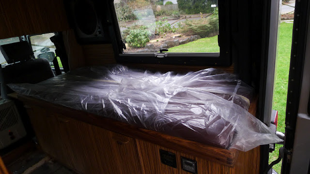

(above) And finally, the bench cushion was done and there it is...

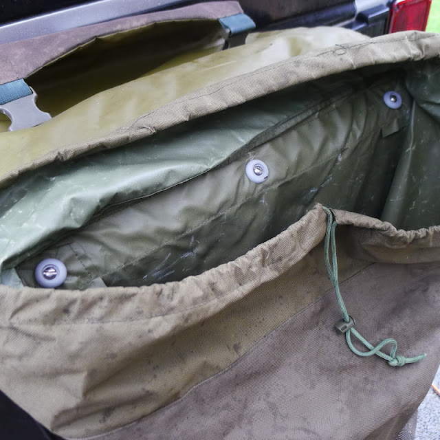

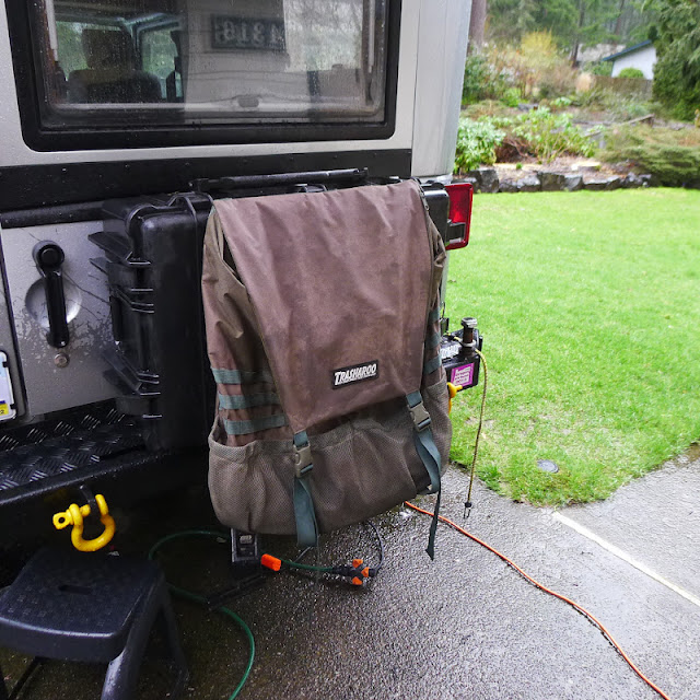

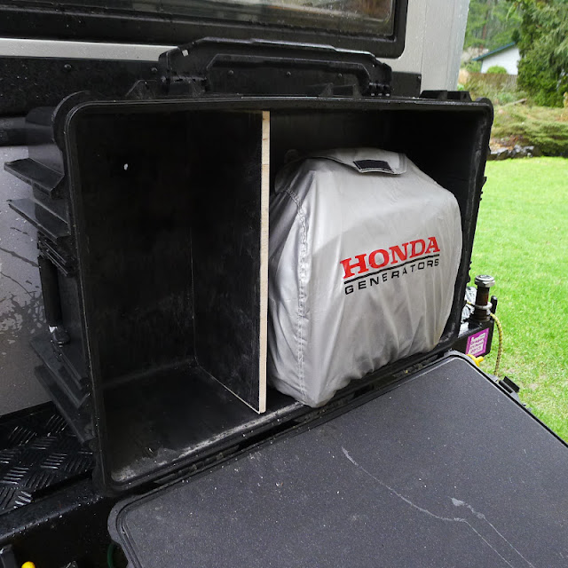

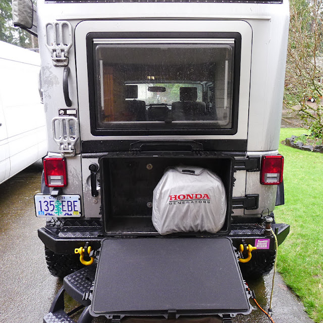

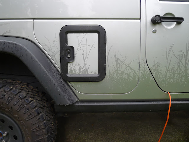

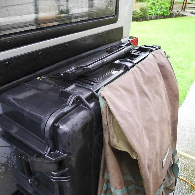

(above) On Mike's last trip up, he dropped off some things for the Jeep...One of them is a small generator to fit in the case on the rear door...The Trasharoo Bag on the back of the box had straps like backpack straps that were wrapped around the black box...To access the box you first had to reach under the box and unclip the straps, then after you were through with the box, the straps had to be re-clipped...Hardly handy...So I cut the straps off and mounted the bag to the box in a permanent manner...
(above) Three stainless steel screws with plastic washers up high, two down low...
(above) Up till today the bag seemed to me a gimmick, but the functionality can't be denied...If this were my vehicle, I'd keep wetsuits and surf gear in it, and there would still be a lot of room left for stuff that could take on some weather...
(above) The inside of the box lid...There is a dense foam pad that fits in the lid...

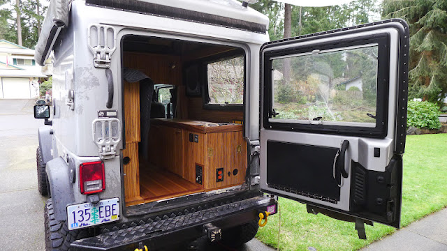

(above) Generator placement...
(above) Scrap balsa-core divider panel in place...It was poly-u adhesived in place then it all got a coat of satin black oil based paint...

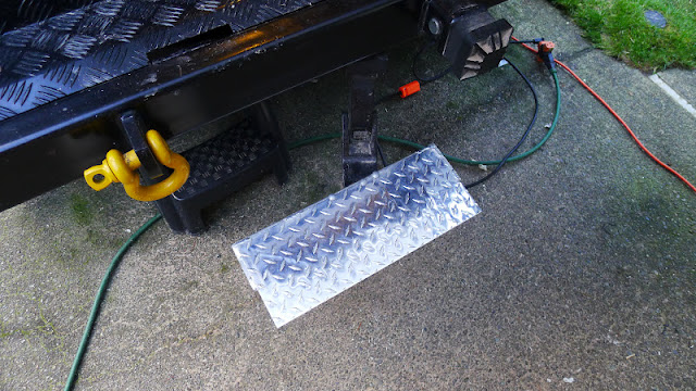

(above) The plastic drop-down step broke a week or so ago...I had this fabricated and test fit it...It needs more work, but it will be fine...

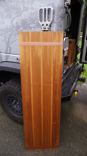

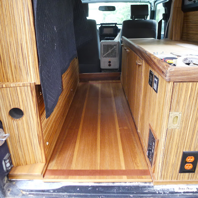

(above) Back in the shop, I sanded and oiled the shower duck board...

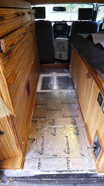

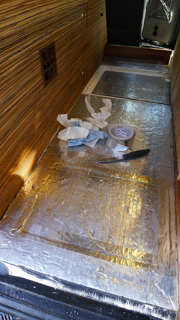

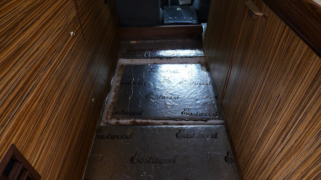

(above) Next, time to finish the shower floor...The Insul-Mat all got cleaned up and the rough edges were cleanly trimmed with a knife...The fiberglass in the shower pan got a hard rough sanding with 36 grit...The few open screw holes from the previous cover were filled with epoxy and sanded, then it all got vacuumed and a final wipe out with lacquer thinner...

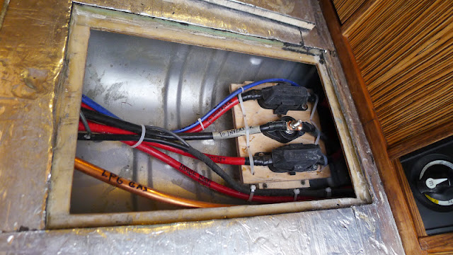

(above) The sub-floor hatch got cleaned out ...
(above) Then the hatch door was taped down with aluminum tape...What you see there is all aluminum...Not plastic...

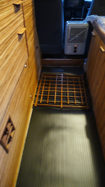

(above) My plan for the shower involved painting the pan black...
(above) The aluminum was covered with ribbed vinyl "carpet-runner" that is attached with PSA sheeting...On top of the shower pan, a piece of the vinyl runner was pattern cut to fit, then the teak duckboard with copper flashing under it was put in place...

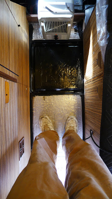

(above) What custom looks like...In everyday use, this will only be seen when the teak floor (3/8" thick) is removed...But it's there...A super thin, silver nylon shower curtain will hang easily from the ceiling tie-downs...More on that later...
