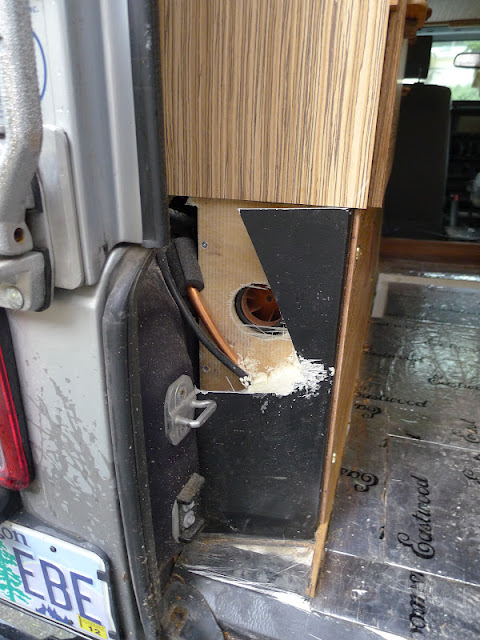

(above) Back in the far rear corner is the roll bar and the connection to the gas manifold...The original plan of having a heater on top of the countertop is history...So instead of having a stainless steel flex line come out of the copper, there will be a valve and quick connect fitting...This affords the option of connecting a heater or another gas appliance...A BBQ or a multiple burner stove, an oven, or ???...The connection is there if you need it...
The problem (for me) was the flex line was wrenched on before the cabinet was in and that flex line need to be removed...Removing it was exceedingly difficult...No room to turn a wrench...It took me close to an hour using several combinations of gripping tools to get it loose and the new stuff put on...I am a man of great patience and this was one of those tests...Confirmed...

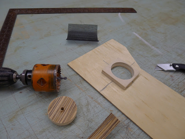

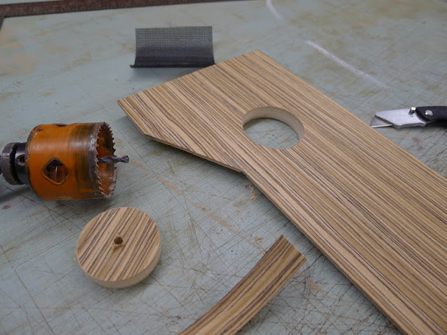

(above) The lower end panel was next...The intake for the gasoline fueled space heater is back there and there was no vent for that...So i put one in the panel...Simple hole and backing block...
(above) The finish side looks like this...
(above) Screen on the inside...
(above) Glued with polyurethane adhesive and clamped...

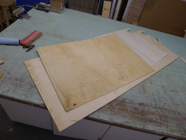

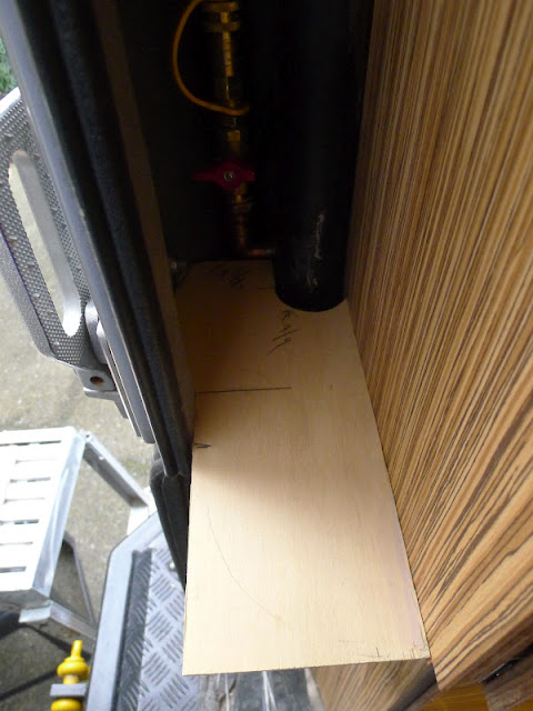

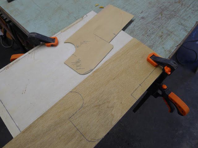

(above) To cover that space, I first made a pattern...

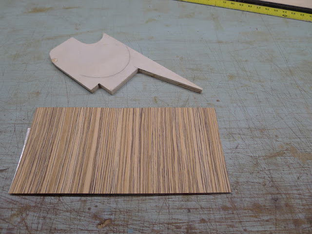

(above) Adjust it, then traced it to to a scrap of 1/2" ply and cut it out...
(above) Test fit...You also see the fire extinguisher that will go in there...
(above) Peel and stick veneer...

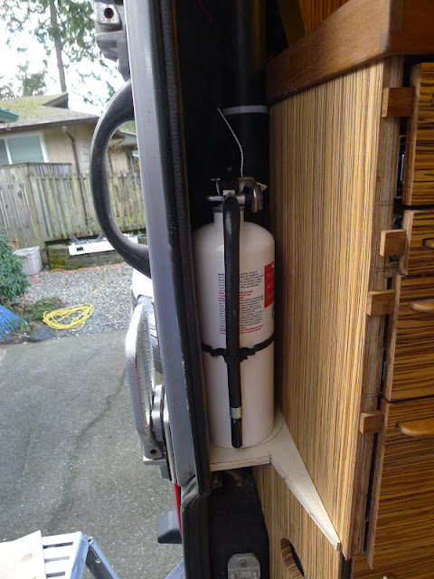

(above) Ready to get installed...First I glued in more support for the shelf to the side of the cabinet...

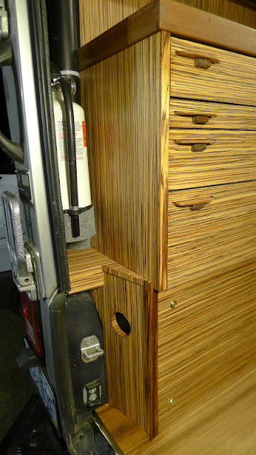

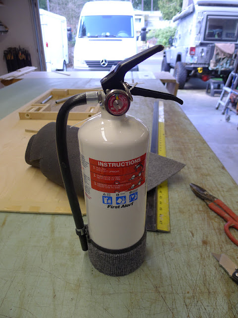

(above) The fire extinguisher will hang from a hook that is bolted to one of the bolt ends that mount the exterior grab bar...Perfect...To keep the extinguisher from rattling around, I PSA taped a piece of carpet to the lower edge of the extinguisher....The roll bar also received a matching piece of carpet...No one likes rattles and this one won't...Custom is about thinking through the details...

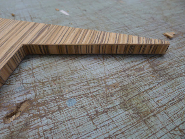

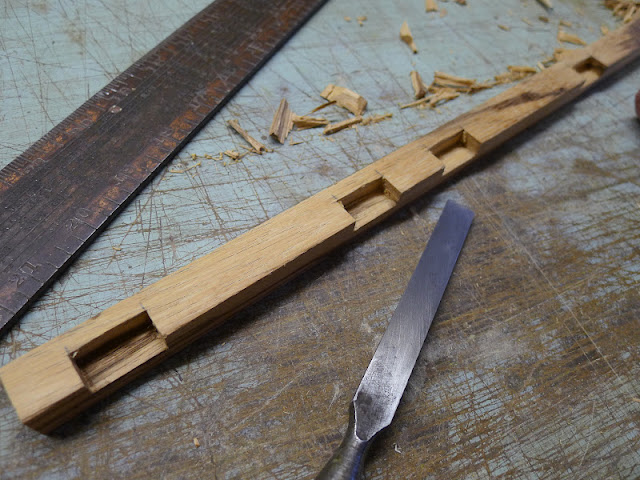

(above) A few other details were finished back there, then it was time to finish the drawer stops / cabinet vertical edges...Hammer and chisel time...These were attached with polyurethane adhesive and pin-nails...
(above) And when it was done, it looked like this...You can also see the teak filler piece at the floor...Also the shelf edge got an apron under it and a piece of veneer covered that...You see the fire extinguisher placement as well...I'm pleased how this all turned out given the existing conditions I had to work with...

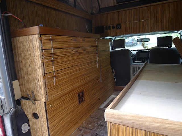

(above) View from the bench seat...Clean...

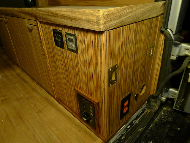

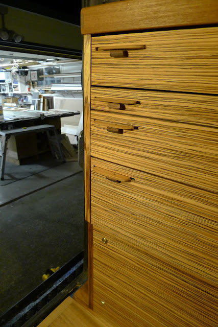

(above) Over on the curb side, the drawers got their edge treatment...Also a piece of teak was put on the bottom back edge of the inverter panel and the battery switch/beaker panel were trimmed in zebrawood... Looking good...

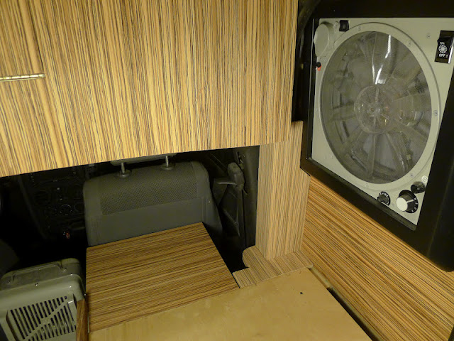

(above) Up front the cover for the pneumatic ram was veneered and installed...
(above) It's all about functionality and that means paying attention to the details...The cushion will go to the vertical edge of the cover panel...

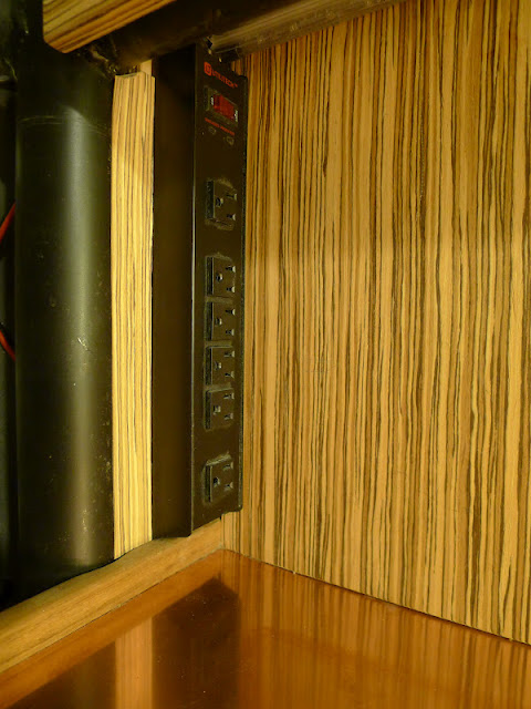

(above) Over on the driver side countertop wall, a multiple outlet power strip was installed on a piece of 1/2" plywood that was poly-u glued and pin-nailed to the teak edge...Over the plywood, extending to the roll bar a piece of zebrawood veneer...I like how this worked out...

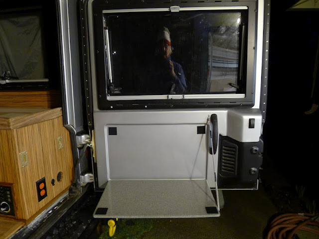

(above) The black panel is a drop down table...There was a piece of duct tape keeping it closed...Classic...That's gone now...
(above) Replacing tape as a fastener are a couple pieces of industrial strength Velcro ...More better...
