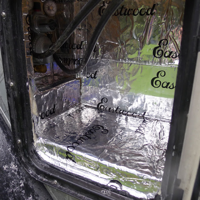

(above) The propane locker has been fiberglassed for a few weeks now, so I sanded the bumps, and...
(above) ...installed the Thermo-Mat insulation ...Nice touch I must say...
