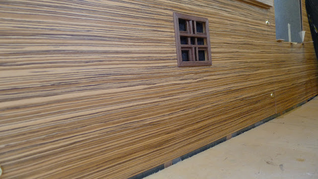

making your own vent out of scrap walnut? Really? Any hope I had of building something in my rig went out the window as all I will be thinking is "Paul Jensen would do this better", "Paul Jensen would make his own hinge to use here" or "Paul Jensen would have hand sanded that so much nicer"

Are you still looking for some brass screen? We weave decorative screen out of all kinds of materials at work and I could probably snag a piece. What size is the vent hole?
Thanks for the offer...
The black screen is fine, maybe next time...

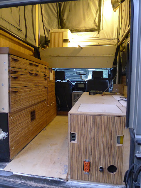

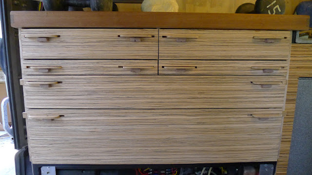

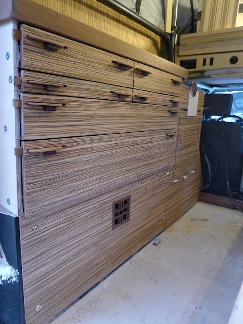

Prepped then installed the driver side drawer faces, then oiled and sanded them, repeatedly...
Today, the pictures will speak for themselves...

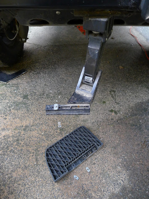

Oh yeah, this broke...Should be metal, not plastic...

You're right about the oil, that looks great!

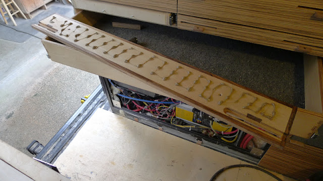

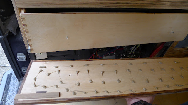

In my experience, hot glue can soften in a hot car. I learned that the hard way during one of SoCal's hot summers.
Doesn't get that hot in the Great Northwest. Sticky glue, velcro and suction cups seem to work up there :) Down here everything just falls off the walls :) :)

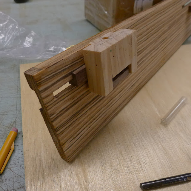

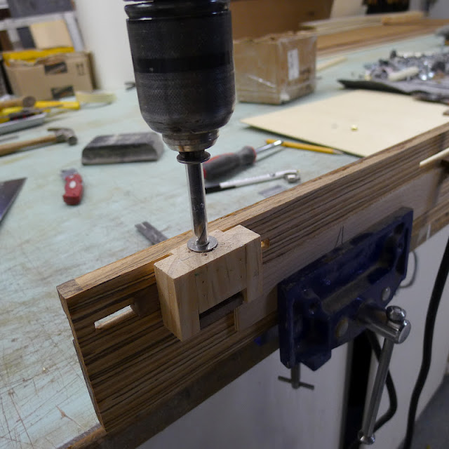

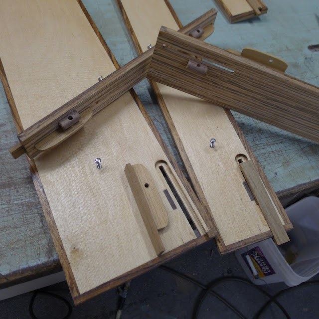

I noticed on the back side photo of your drawer fronts that the little blocks you have added to the front are actually morticed in. How did you do this and how do you get the 'slots' for this and your slide locks to be square? Is it as simple as router and chisel?
