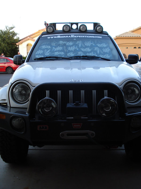

Guess who installed a set of LightFoce 170's?
Yup, me! They look right at home on the KJ...

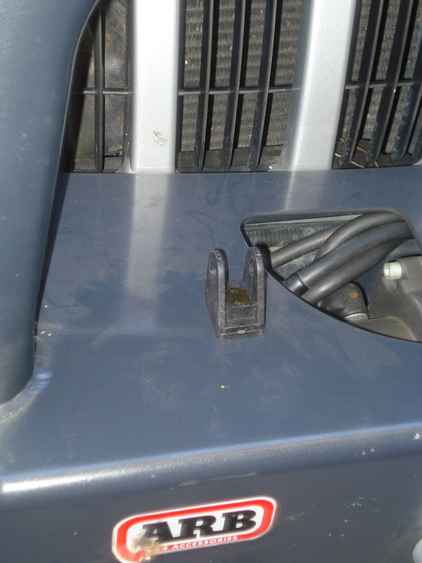

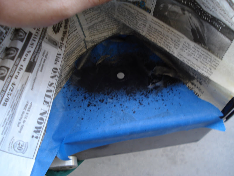

Mounting was pretty basic... I removed the odd eyelet that was used as a winch hook hold (that took the longest!) and a LightForce Wiring Harness.
Once the eyelet was off... the ARB Bumper got a touch up paint job to prevent rust as seen below:
Once the paint had dried for 30 min... the tape was removed....
And the mounts were installed:

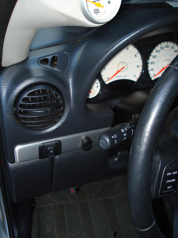

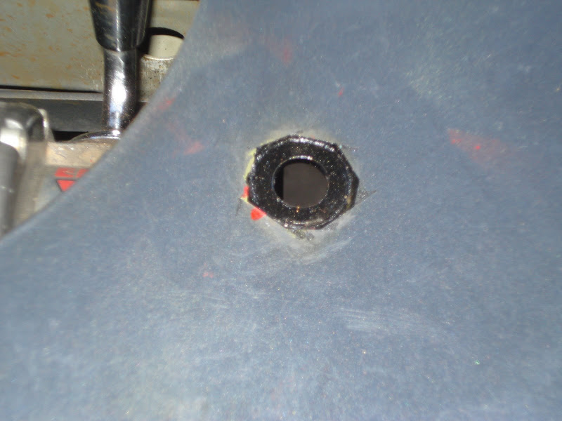

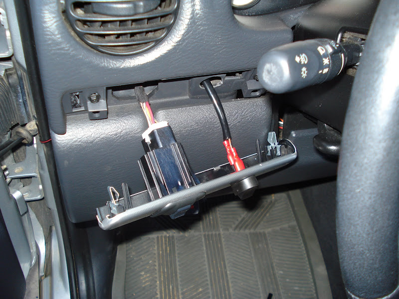

Switch was mounted next to the factory roof light switch. The hole had to be drilled through both the metal facet and the two layers of plastic.
Then the switch was installed and the molding placed back onto the dash. Looks pretty good to me!

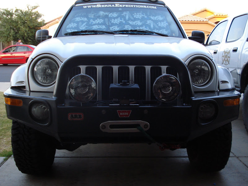

All done!!!
