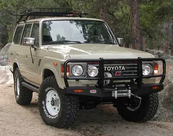

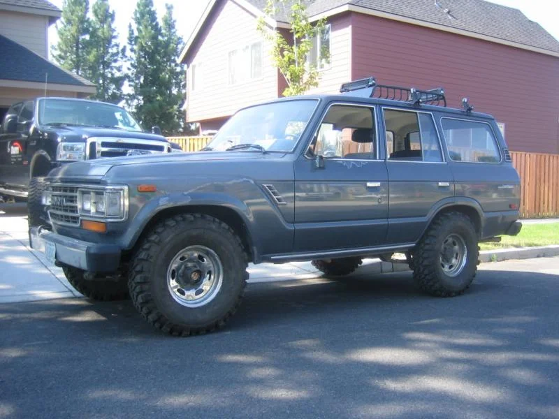

I have 31's on the truck now.... I dont like the look of it. I'm wondering if I can fit 33s and no lift (or with AAL)? :sombrero:
Just searched Mud--- yes it can fit.
33x12.50 (above)
33x10.50
33x12.50
And for reference...
33x10.50 with a 3" lift.
