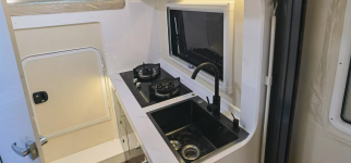

What's with the 2 rods under your dinette table?
When a dinette table rests even with the bench to create a bed, most engineering requires a 3/4 -1 inch strip of wood, a lip on each bench, for the table plate to rest upon.
These tubes are inserted currently for transportation.
However these tubes being removable with a twist are table supports for the bed.
During seating they are removed with a twist and stored.
