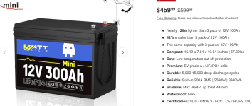

This is one of the most efficient and least expensive to use batteries, even so you have to spend a lot on the electrical system to support an air conditioner.
Have you noticed how lithium batteries have dropped 80% in price in the last 24 months?
