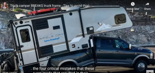

The reason not to build on US pickup trucks platforms
That's a pretty broad statement and one that I don't think is really justified.
There have been numerous examples of chassis breaking on Fuso/Isuzu light trucks, simply because of poor design choices or, probably the most common, bad weight distribution.
One problem, as I see it, is that there are not a lot of hard fast rules in the US when it comes to how campers have to be built. That is definitely not the case in Australia.
A case in point is the amount of overhang that is legally allowed behind the rear axle.
Here there is what is often referred to as the 60% rule, where the maximum overhang cannot be more than 60% of the wheelbase past the centre of the rear axle.
This is not limited to the main structure of the camper, but also includes anything else that is stuck onto the rear, like a motorbike carrier for example.
Good design is the key, not necessarily the type of vehicle being used.
