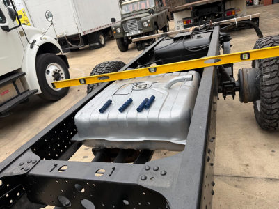

A few pics of truck
(Isuzu hub pattern on super singles)

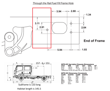

Working on a 2nd fuel tank , spring mounted.
(subframe spacing off the truck frame is still a bit unknown, due to clearance as you can see)
With a rig like this, my project is self managed. Going to a major builder and asking for a turn key, drive away, be prepared to add $100K addition to the cost.
I did not see this challenge until just recently. The location for attaching the rear spring bracket is actually behind the end of the subframe. All due to the leaf spring rear mount. Working on solution. It all takes time.
The truck frame is six inches longer than the habitat. This I knew. As I have a 18 inch deep rear storage box attached to the habitat.

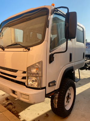

The first few months, maybe six, were decisions and platform discussions. Then there was a pivot about six months in, to stop the DIY 4x4 build on the chassis.
I started the isuzu 4x4 conversion with a vendor, and that was finished about six months ago. (pics of my truck are shown)
In parallel I worked with a build on the habitat, which took six months of planning, then manufacturing and finally delivery about eight months ago. (pics of my habitat are shown)
All with posted pictures of the milestones achieved.
Yes, there are still many tasks to be done.
About seven months ago, we started the subframe and spring mounts. currently about 80% done.
