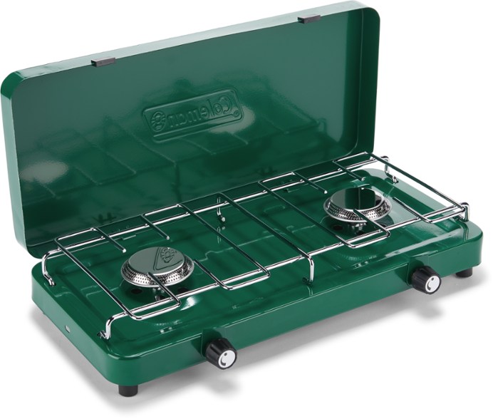

hoser
Nice! I was actually thinking more like a 2/3 version. Double burners, I need...
I don't know how accurate these dimensions are but:
16 x 7.25 x 2.5 inches
Coleman compact stove:
190,567
2,929,261
234,224
