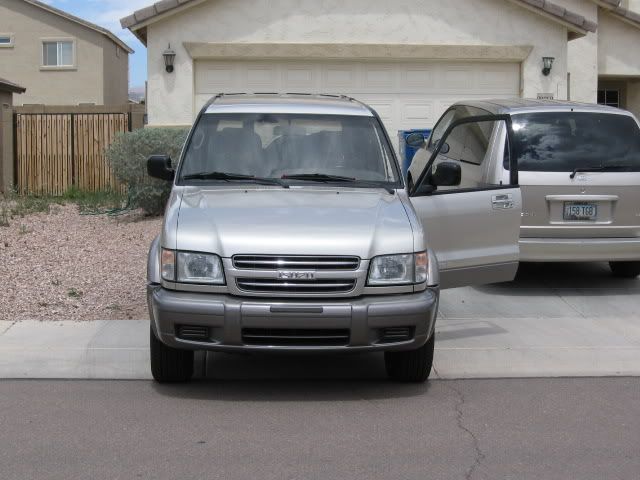

If going with the 3" I'd swap to lockable hubs. The angle on the front cv's gets pretty steep. You dont want 'em turnin' all those miles on the highway. How does a 3" lift effect the driveshaft and pinion angle on the 2nd gens?
yup, agreed...i would also not run a 3 in. lift.the angels on the cvs will be bad. just get the ome lift and the spring change will be all the lift you need. i run a 255/85r16 with the 5spd and have no rubbing issues at all. your front end needs the down travel. All of this is moot if you want to contact Joe Darlington to fab up some diff drop brackets to correct the angels on your cvs and restore your downward travel.

here is a few pics of mine as it sits
its a 98
3 in OME with spacer, stiff springs
It also has air lift air bags inside the coils. this really helps when loaded down with lots of gear
