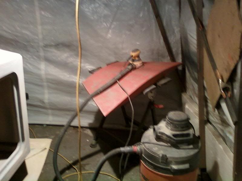

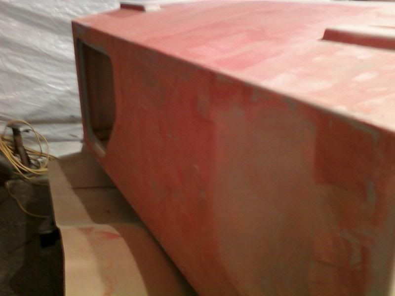

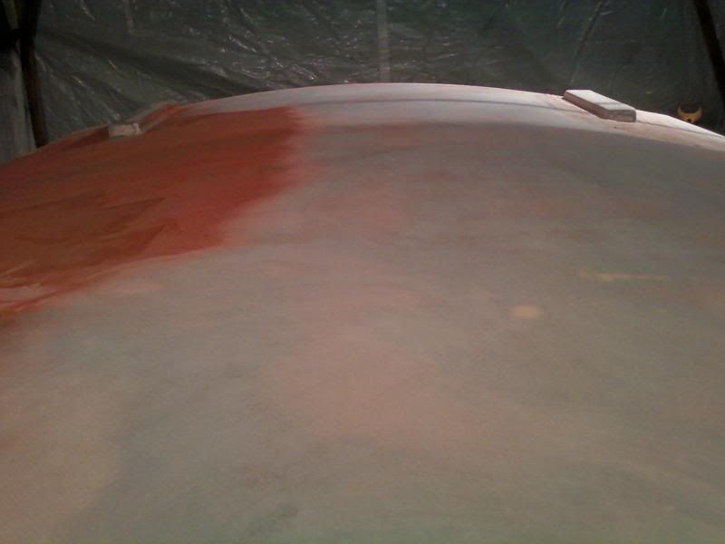

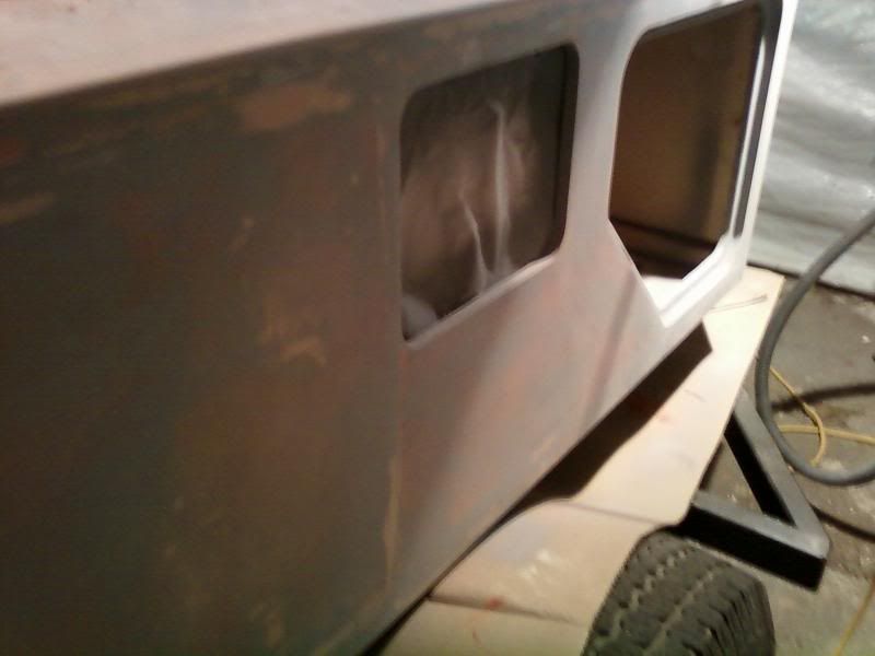

Just an update to stay current. Been working on the exterior trying to get it where i want for paint. Needs one more coat of primer and it will be good to go. went from gray to red now back to gray.

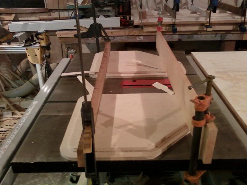

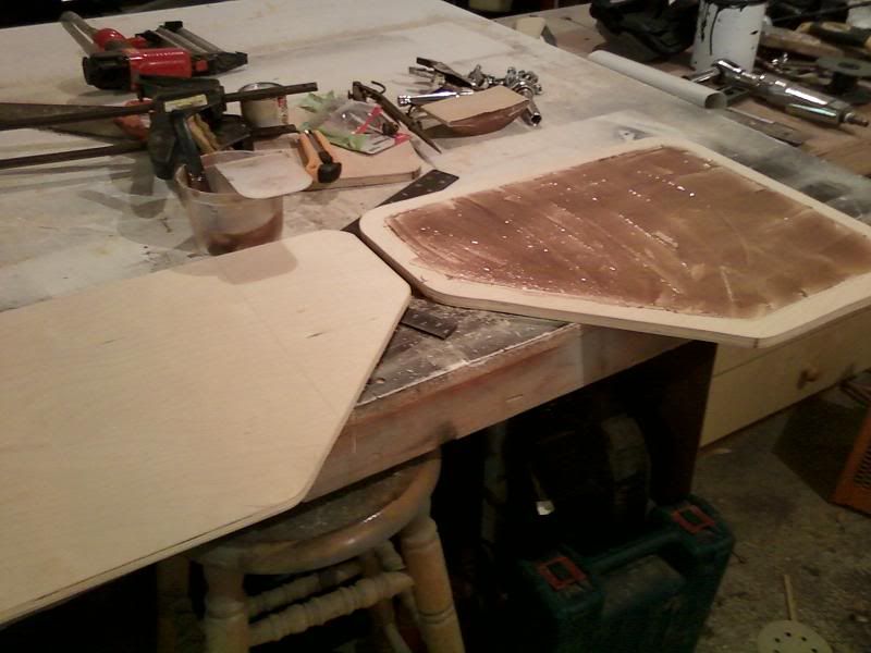

Assembled the rear doors they been on my flat layup table for a few days now they are dead flat. did the same with side doors but used my table-saw for flat.
Tomorrow last of the primer and then on too paint.

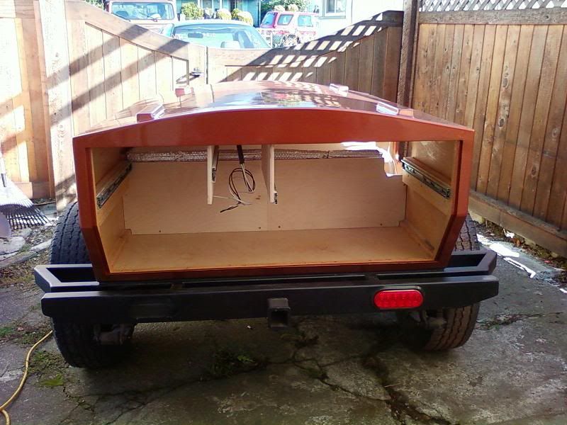

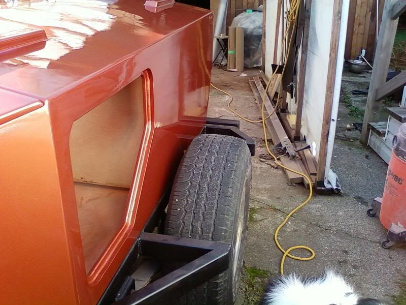

Yes same as the YJ just finished spraying the base coat needs to dry for an hour or so and ill shoot the clear ... Pictures later :)
Wavebreaker

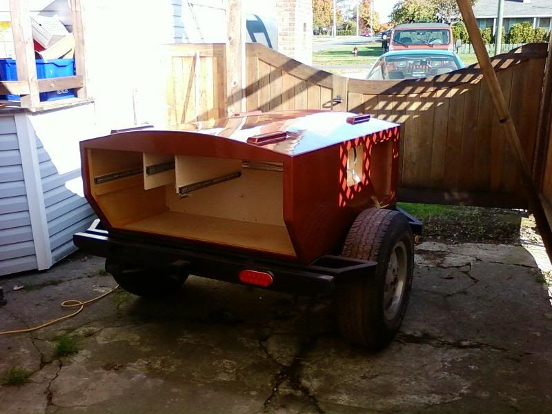

Got the pod painted over the week end it tuned out pretty good despite the bugs landing in my clear coat :) Color matched to my Jeep.

Heifer Boy
Looking great Wavebreaker! I like it and it's nice to see something a bit different colour-wise. Are you colour-matching the fenders or going with black?

Holy Crap that paint looks good Mike!
Very nice job, bugs and all. I am glad you went Jeep Body Colour on this build, going to look awesome rolling behind the YJ. Cant wait to see it in person...need to drag my butt over there.
