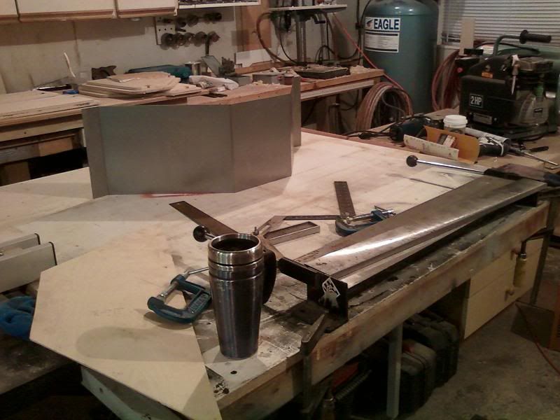

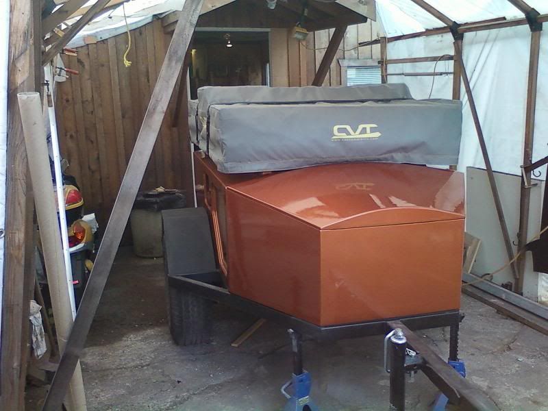

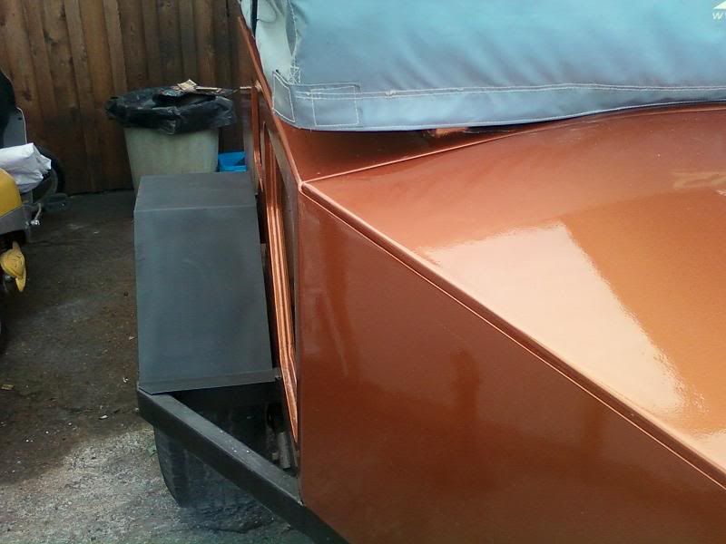

Spent a few very humble days learning what not to do while welding sheet metal.

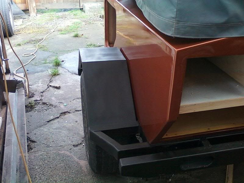

After a few trips to the metal store, i have a set of fenders i can live with.
Fenders are sitting loose waiting to finish a couple other bits first.

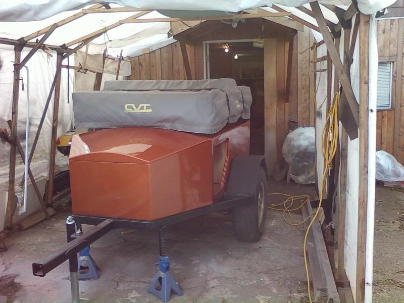

RTT is mounted for the last time.
Dusted off the old manual metal bender and bent several fenders...
D

Really nice work there! It's amazing how a properly proportioned set of fenders really finishes a trailer off. Excellent stuff :wings:
indiedog
Looking fantastic, love the finish. :Wow1: For your fenders, given you've got nice curves on the main box, and rounded corners to all your doors, could you roll the bends in the fenders rather than sharp bends? They just look a little "angular" compared to the rest of it. I'm an architect, can't help myself with some of these things. Sorry.

Indiedog: Ya i know they look a little out of place but i cut my doors etc for the angled fender. Plus once fuel cans etc are in place you wont notice them to much I HOPE ! :Wow1:
indiedog
Wavebreaker, I don't mean to make the entire fender curved, just roll the bends instead of sharp angles at the change in direction. A bit like your doors are with straight sections, and then a small radius bend, then another straight section. It will still fit your doors.

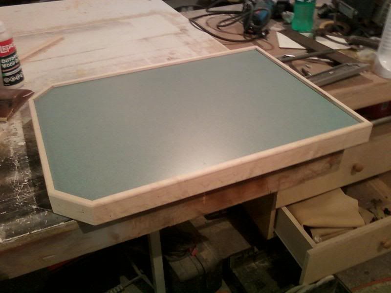

small update: Just working on tiding up small bits and pieces,the list grows daily.

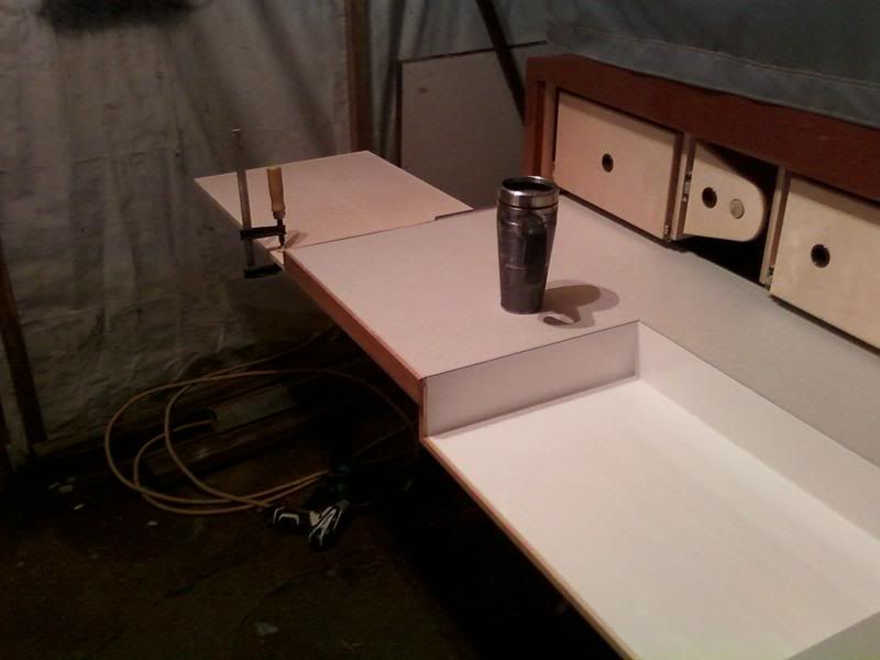

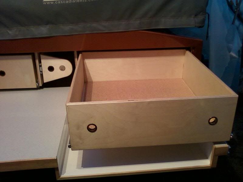

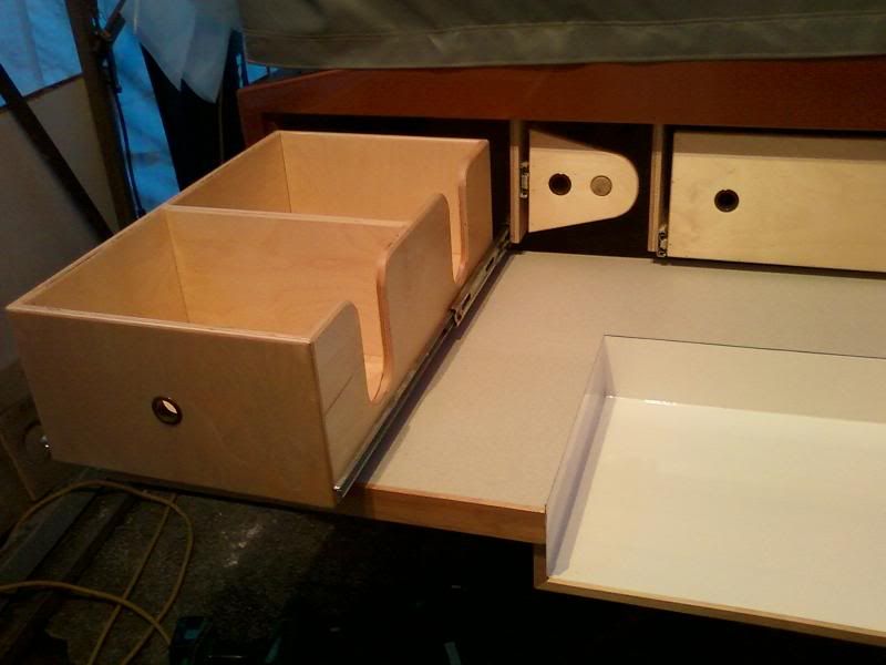

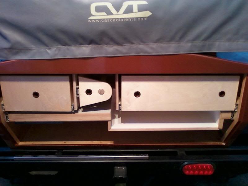

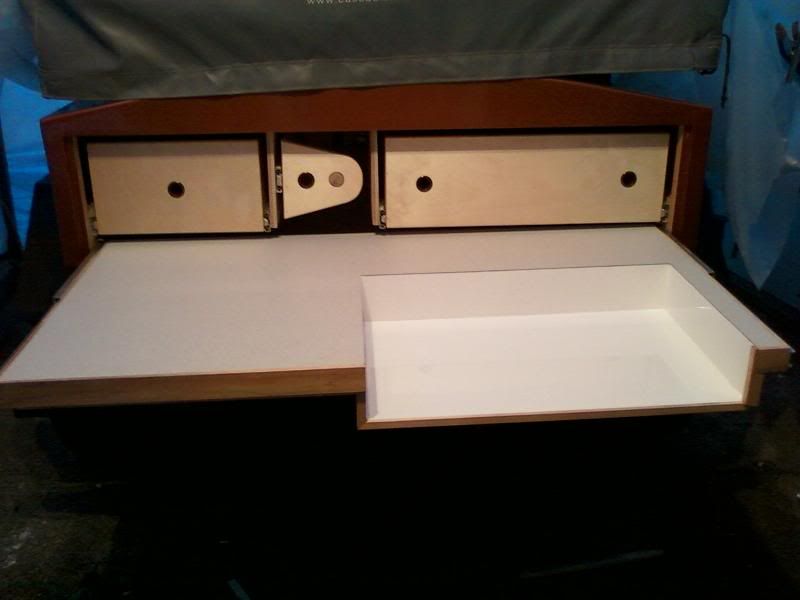

Got the last couple coats of finish on the galley drawers and counter. installed them and designed and built my counter extension. It plugs into the main counter on 2 half inch steel rods. comes off and stores under main counter when it is closed up.
One more drawer to build now the extension is done. and galley will be finished for now.
Then onto doors and stabilizers for the rear. plus a dozen other things.
design stage.
laminated and maple trimmed.
Plugged in
setup for use.

Damn.....is that slick. Going to be a nice place to cook! :coffeedrink:
