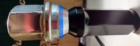

FYI, I had looked into swapping hubs, but then got into the issue of JT/JL using not only a less then standard lug stud size, so not a press in new studs to get the hubs to work, but also a deep taper on the lug nuts so not matching. Maybe not an issue with the Rams (although they share a 'parent company').
PLUS 'normal' trailer wheels and your TRX wheels are going to have a crazy difference in offsets, so unless you build an axle planning on that (certainly due-able), you are going to run into interference with the side of the trailer regardless if it is enclosed or open which spacers/adapters cure, For me not worth the hassle of building a new axle and hubs on a <2500 lb trailer which $80 worth of adapters/spacers made work perfectly. 5000 lb + trailer, I do it differently. YMMV

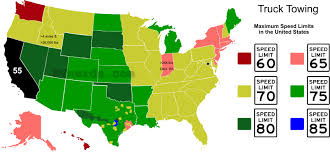

Not all states restrict trailer speeds, when they do, the speed limits apply to trailers seem to be set by weight limits, from what I've seen. Tractor trailer rigs may have different limits and are designed for higher speeds than your utility/camper type. A dual or triple axel 34' travel trailer will be subject to the speed limits just like a 4x8 utility trailer, the fact that it might track well at 85 mph isn't the issue, it's illegal.
I'd say it may not matter how you design a small motorcycle trailer, single or even an unnecessary dual axel, you will be subject to the speed limit laws set for smaller trailers. Best is just comply and make life easier.
My 4x8, I'm sure could cruise at 85 mph, but I wouldn't do that, a tire blowout can happen due to several reasons, just because my tires are rated for that speed doesn't mean they can't blow out. I don't know anyone running "run flat" tires on a trailer, but I doubt a cop would care.
I'm saying, you're not going to "design" a go fast motorcycle trailer that will be be allowed legally to go faster than any other run of the mill stock trailer of it's size. No special width, length, height, wheel/tire size or axel rating will exempt you from speed limit requirements.
