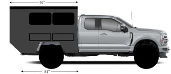

Something just crossed my mind - I want an 8ft long camper, but does that necessarily mean I need an 8ft bed truck?? I was planning to add a rear angle to the camper to help the departure angle. That means the base floor/subframe is going to be shorter than 8ft and perhaps, I just need 6.75ft truck! If this works, I can get a supercab while retaining almost the same wheelbase! I'm thinking, why didn't I figure this out sooner lol. Do you guys see any flaws with this theory?

The supercab short bed is a great combo. U-turns are no big deal, switchbacks are 3 pointers rather than the Austin Powers wiggle. You can parallel park in town, etc. One of the biggest reasons for us to go with the f-350 was the slightly longer (short) bed and the supercab. We don't need a full 4 doors (just dogs riding back there most of the time) and didn't want the extra wheelbase.
Our camper is an 8' model but built for a short bed. Only hangs past the bumper a few inches. So far we have not found any issues with departure angle of the camper, but I have drug the hitch mounted steps a few times but have also drug the hitch sans camper so not much difference there.
I think the biggest issue will be COG and putting some weight on the steer axle. Batteries, water tank, etc all need to go right behind the cab. Ours has a pretty large cabover area that certainly puts weight up front.
As for capability, these bigger pickups do pretty well. The factory locker is great, and ditching the sway bar helps let the front end move freely. Having 2k lbs in the bed makes them pretty 'point & shoot' in 2wd. It's a slow ride on the rough roads though, lots of weight to shift around, tree branches to watch for, and hoping that your cabinets don't get completely scrambled.

If you take a look at the drawings I posted in this thread, my design is relatively simple. It's basically a 6'x8'x5' box with a pop-up roof. There are tons of DIY videos on YouTube about building overland trailers and truck toppers with a wedge-style pop-up roof. I like the idea of using aluminum extrusion for the pop-up roof, and I might borrow that concept. The T-slots will be a convenient place to install brackets for an awning and other gear, like traction boards on the roof.
It's going to be a big project, though. After some research on this forum, it doesn't seem too complicated to hard-mount a camper on a fully boxed frame, as long as the shell is structurally robust. That's where I need to do a lot of study and maybe even seek some professional engineering services. I think the total cost of building the camper wouldn't look that bad unless I end up scrapping tons of materials

That will work. It's the route I would choose if I were you. Try to keep the center off gravity as far forward as possible. Ideally it would be in front of the rear axle. I think you can stay below 1500lbs dry but loaded up I would bet it'll be higher.

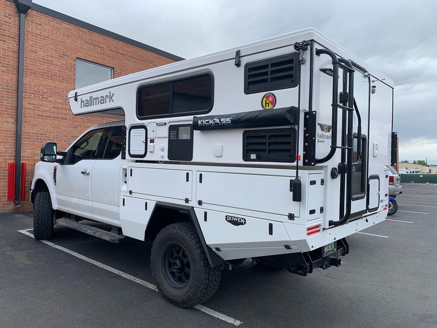

Yes, you can make your camper 8' on a ~6.5' bed. Here is one example that I like the look of. One nice thing about making the bed for a slide in, is that you can easily trade the camper. It gives you more external storage also, if you will be mostly outside.
Same bed on an supercab or whatever Ford calls it:
