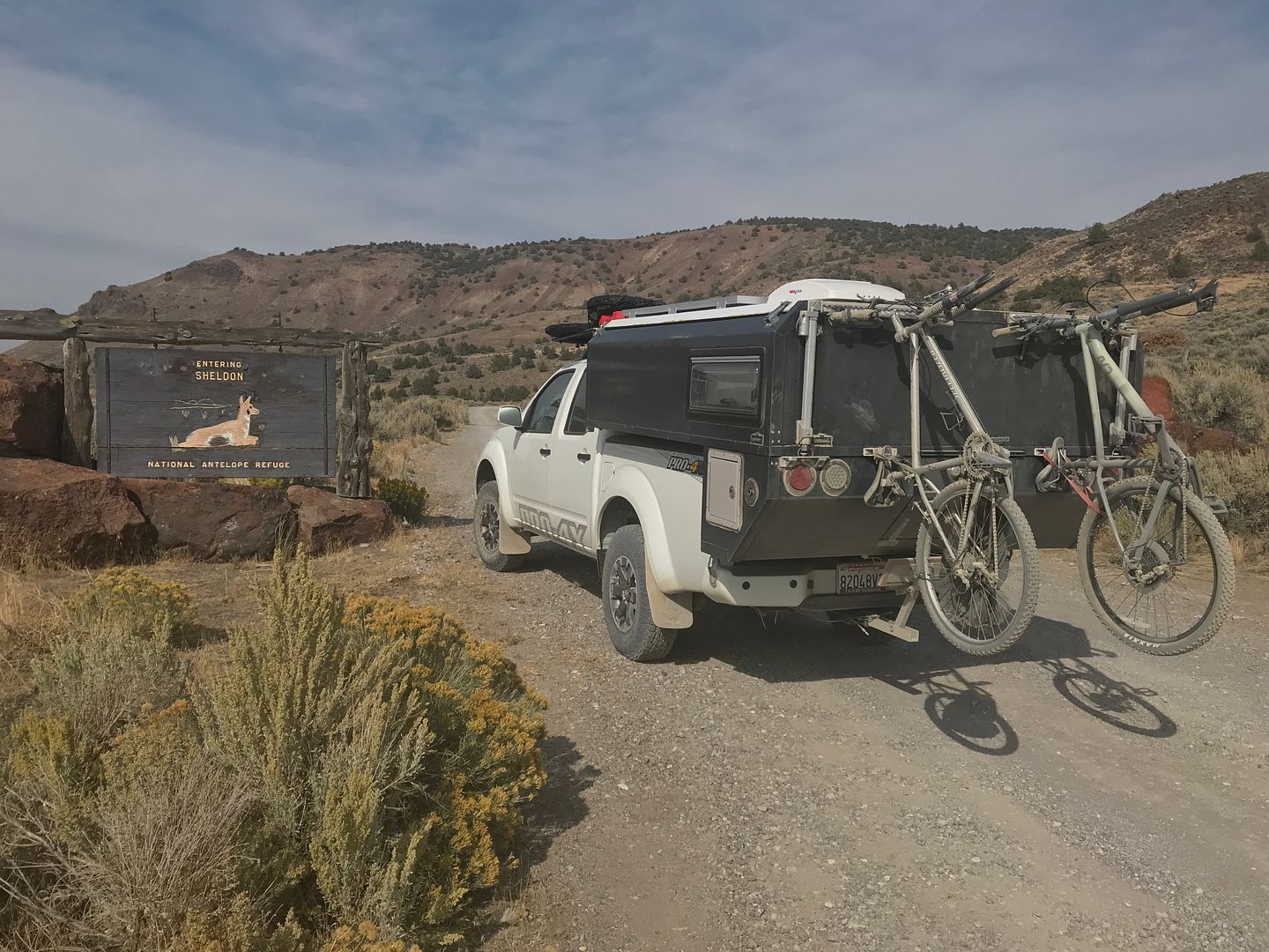

Managed to figure out a way to carry a couple mountain bikes
