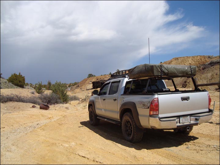

Then it was time to put everything together in the bed and make sure the tonneau was gonna fit with the new system and the Frontrunner rack etc. I also needed to get the final measurements for the weatherstripping that I later used to seal between the bed rails and the tonneau rails.
pics from the mockup:
tonneau rolled up:
tonneau rolled down:
Everything fit together pretty well at that point, it is a little tight getting the header installed with the extra thickness of the steel, but it works. Much stronger and more stable than the original mounts I had made.

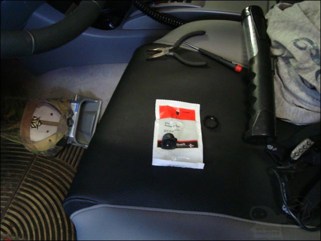

here's the rocker switch I picked up at Radio Shack:
Here's where I installed it, next to the hood release. You can see the two leads for the switch coming out of the cubby hole. After this pic was taken they got wired up to the switch and everything got put back together

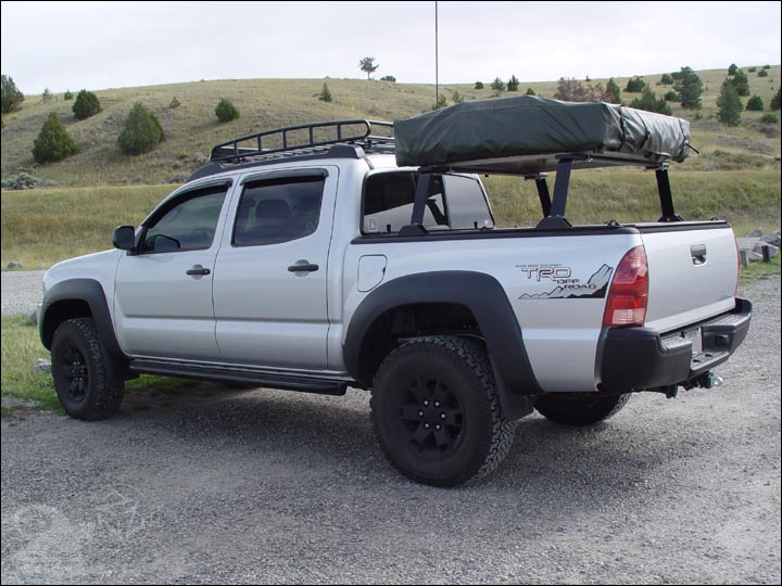

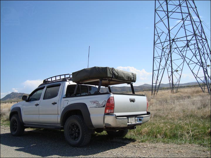

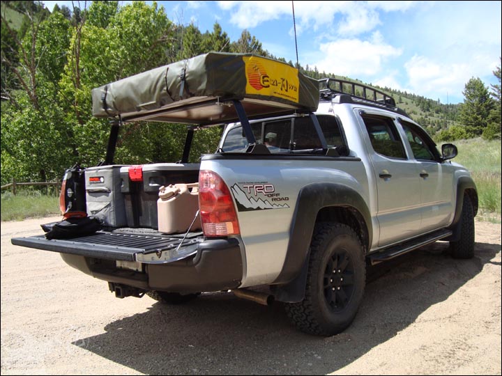

some shake down pics
after I got the rack mods finished we took her out to make sure it wasn't going to come apart and dump our tent in the trail. As usual, wifey had the camera handy :cool:
zapping some prairie rats over on my buddy's place

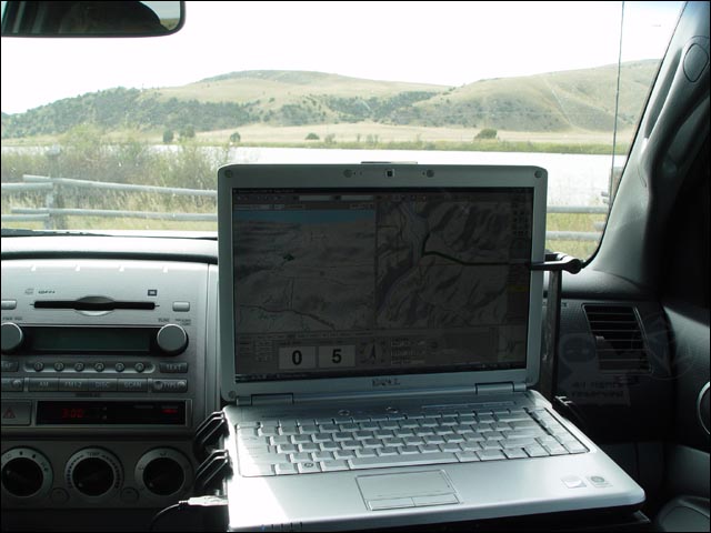

RAM Mount

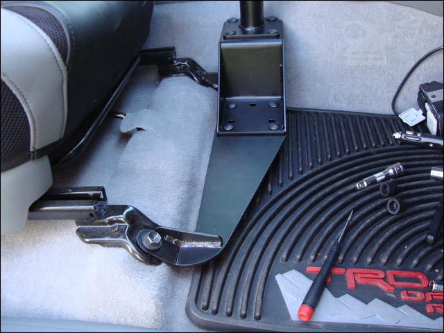

I went with a RAM mount for laptop mounting solution. In the future I am contemplating a netbook or tablet and mini-mount system instead which would take up less room, but for now this is working pretty good..
components unpacked:
pic of how it mounts to the passenger seat brackets, very solid.
install was simple. I ended up taking out one section of the arm to save some room, and it still has plenty of adjustment range for both driver and passenger use.

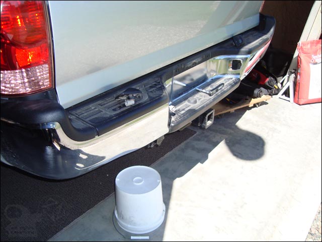

rear bumper bedliner-ized

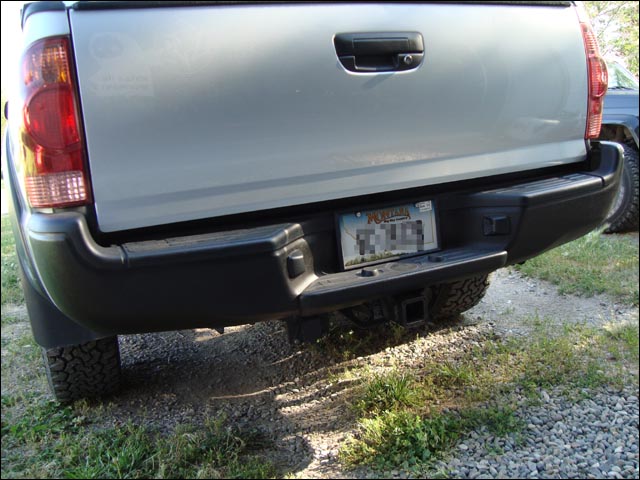

then my chromaphobia flared up again and we had to kill off the last remaining chrome on the truck, the rear bumper.. So we picked up some roll-on bedliner and wifey did a great job with the coating while I was working on the toolbox and dual 12 volt setup..
getting prepped:
First coat.. looks like crap!
But after the third coat it looks great! Here it is all re-assembled with some road dust too..

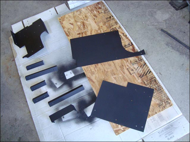

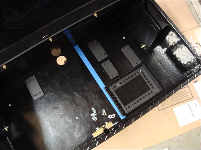

ripped the old junk out of the truck and started laying out the interior of the new box:
sub-structure brackets all complete and painted:

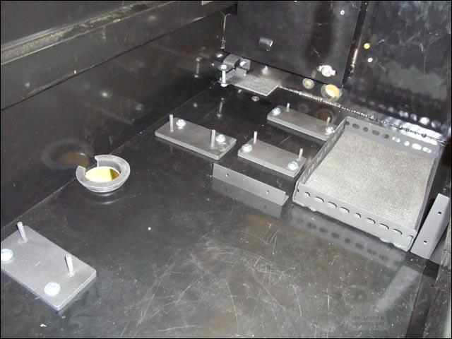

test fitting the dividing wall and shelf:
drilling more holes.. pressure switch bracket completed

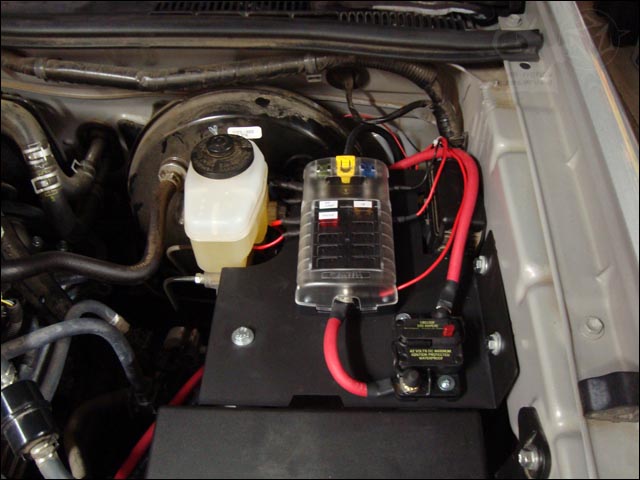

making a pattern for the underhood bracket plate to hold the BlueSea fuse block (thanks barlowrs!)..
test fitting the bracket plate under the hood. made this out of 16ga

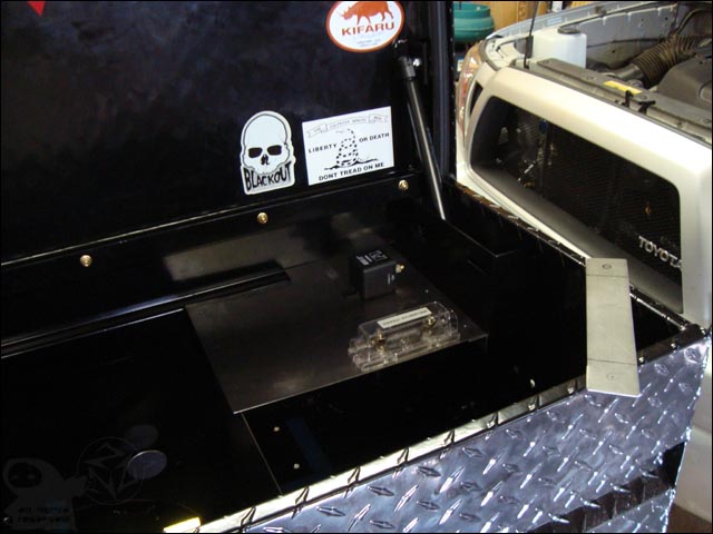

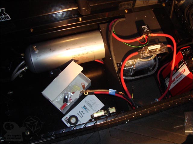

laying out the shelf components, IBS relay and fuse holder (also started installing some stickers lol)

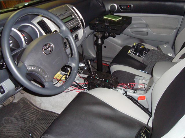

center console disassembled, running all the wiring for the battery controller module:
All remaining metal parts getting paint:
Installing the battery controller module in the center console. Made this little bracket with velcro to hold it place, worked great!
battery controller in place:

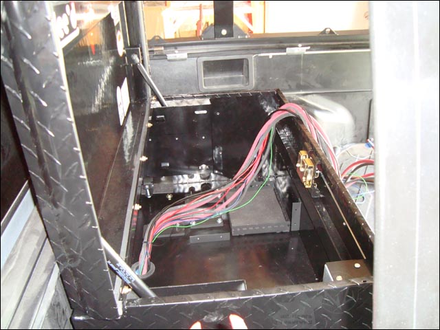

finally time to mount the box into the bed, all brackets bolted in first..

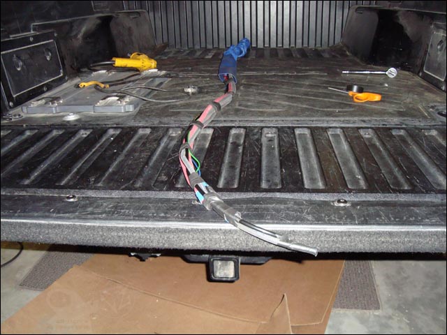

giant wire snake creature routed up into the bed..
box mounted to bed and ready for components!
cont. in next post..
dual battery / toolbox cont..
feel like i spent a couple days living right there getting all the junk installed lol
connections to the fuse block complete, 12 circuits should be plenty of room for all my future electrical needs under the hood.
inside of box almost complete, all wiring and components in place just waiting for the battery...

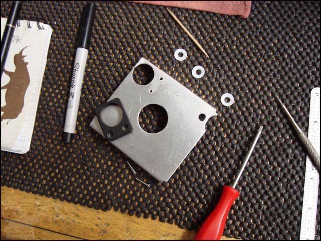

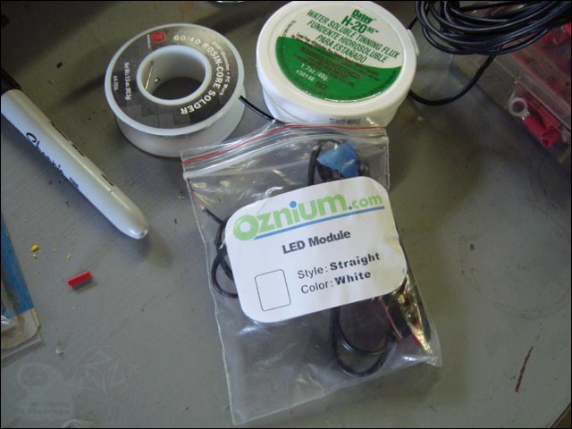

wanted to add some illumination to my box o magic, so i got a couple of these 6LED modules and a switch from oznium
modifying the plate from the latch in the toolbox to accept the switch, made a g10 standoff plate to prevent interference from the latch..

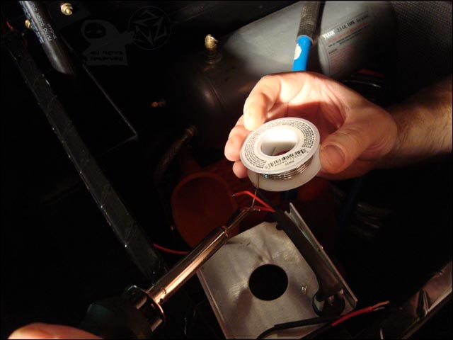

soldering in...
connections complete, switch on!

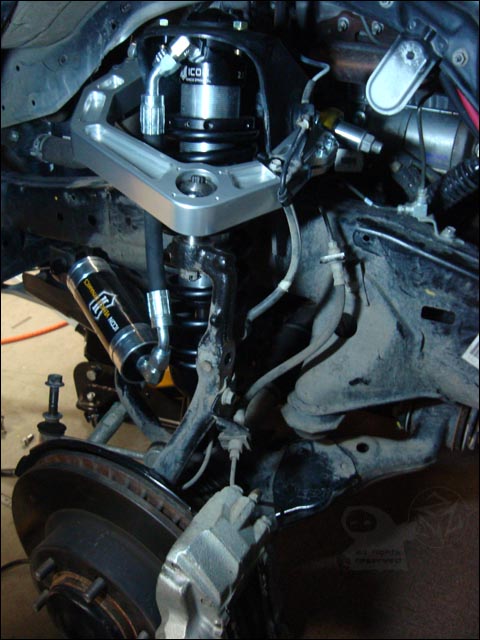

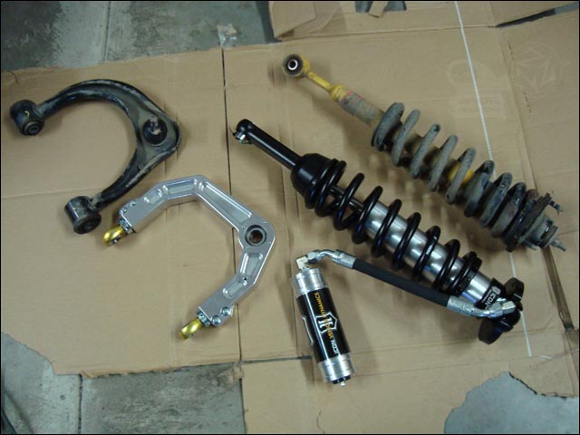

front suspension

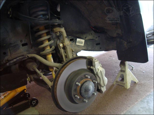

I think it was about in here somewhere that I re-did the front suspension.
Before:
After:

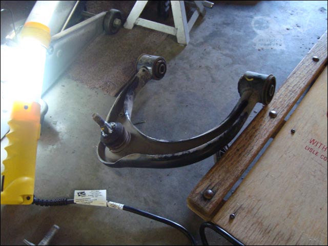

some pics of the process:
pickle forking the ball joint lol wut
a pain to get these out, the pivot bolt is trapped in the engine compartment and took some bending of the sheet metal to get it out..
the old and the new

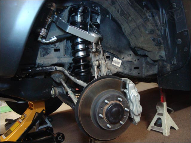

new control arm in, this pic shows the taper adapter that connects the spindle to the uniball in the arm, pretty cool system..
coilover and upper arms in place, time to mount the sway bar relocation plates and brackets for the rez cans
pic of the passenger side showing the can bracket before can is attached..
drivers side all buttoned up

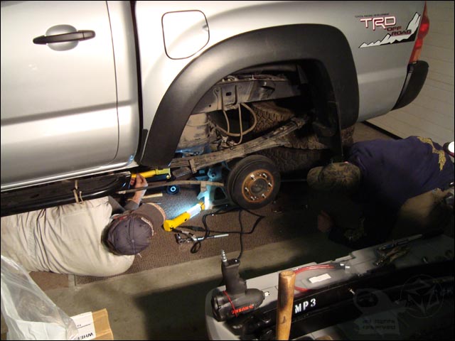

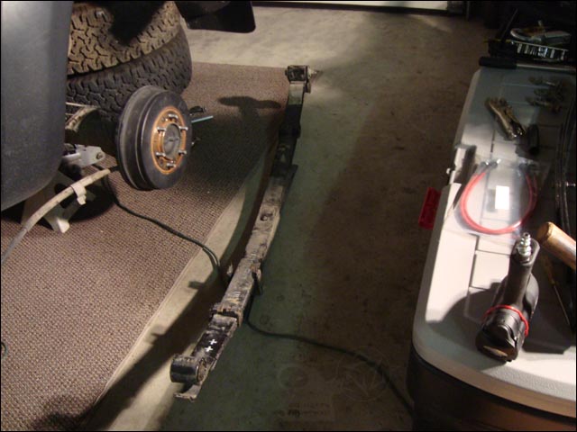

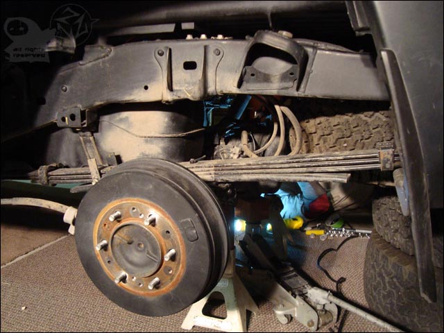

first thing was to get the old junk out..
removing the leaf springs, always nice to have some extra hands around for this..
rear springs out.

around that time I picked up a GlobalSat waterproof USB GPS antenna. We started using it on the laptop in conjunction with DeLorme Topo and it is working great so far. I will get more pics of the GPS puck hardmounted to the rack soon.
