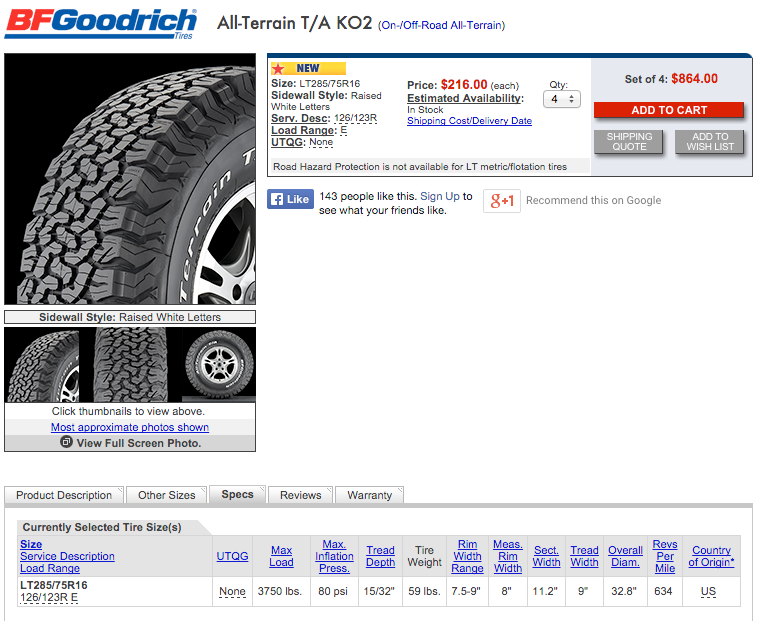

New Rubber!
285/75/16 BFG AT KO2's
I decided to go with the bead balancing this time and purchased .36 gram 6mm high quality airsoft pellets from Amazon : http://www.amazon.com/gp/product/B00N1KHKHC/ref=od_aui_detailpages00?ie=UTF8&psc=1
Using the chart Equal has on their website : http://www.imiproducts.com/assets/pdf/equal-quantity-chart.pdf I determined I needed 6 oz Minimum per tire. Cross referencing a few of the other internal tire balancing options (http://www.innovativebalancing.com/BigTirechart.htm) between 6-8oz is the range suggested for the 285/75r/16 tire. One bag of the BB's above weights about 38.10 split among 5 tires gave me about 7.6 oz / tire.
I've only driven for 10 minutes today, but the tires felt flawless from 0 - 70 mph. Looking forward to putting more miles on them.

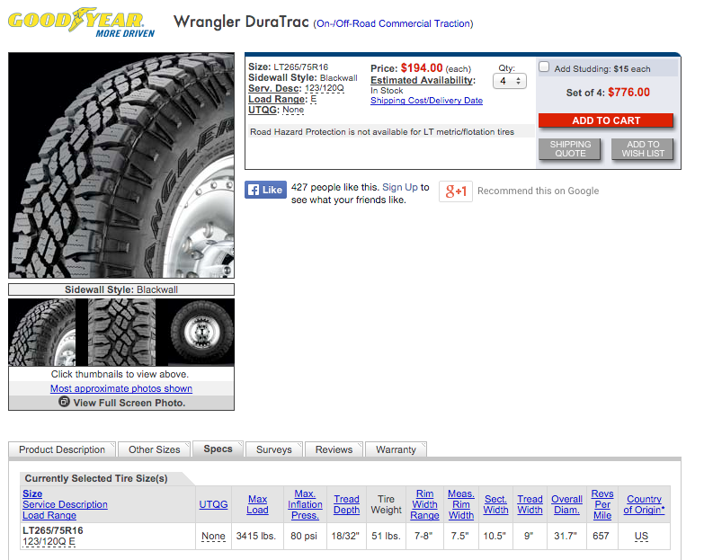

My Goodyears were fairly cupped and very difficult to balance. I had minor vibes no matter what pressure or speed I was going with the tires and they were loud as hell!
These new BFG's are quiet, and balanced perfectly even at 70-75 mph. The BB seem to be doing the job. Upon coming to a stop you can hear them fall and hit the rim, kinda sounds like pouring cereal into a bowl. Hardly noticeable. They fall out of rotation at around 1-2 MPH coming to a stop. At starting again you can occasionally hear them bouncing around until you hit 15-20 and they find their home around the outside of the tire.
Given that they are E rated tires, the shop definitely overinflated them for the weight of the TJ. I'll be playing around with chalk today to determine the right pressure.
After the two long road trips over the next weekends I'll report back on mileage changes a bit more road characteristic feedback.
Specs on the tires...Out with the old...
...and in with the new...
