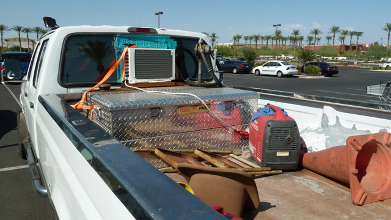

Running truck idle all night....
Do this instead;
