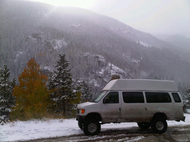

Woke up to the first snow of the season - what better time to go for a shakedown run?!
Berthoud Pass, meet Vantom.
I chose this route because I spend nearly every weekend skiing at Winter Park.
I couldn't find anywhere that I even needed to use 4wd :(
But the big guy did GREAT. This was mostly just a chance for me to get the feel for how he handles on slippery roads, slow, fast, etc.
Grabbed him a drink in Winter Park:
And the clouds broke on the way back home. All in all an incredibly uneventful trip!!
