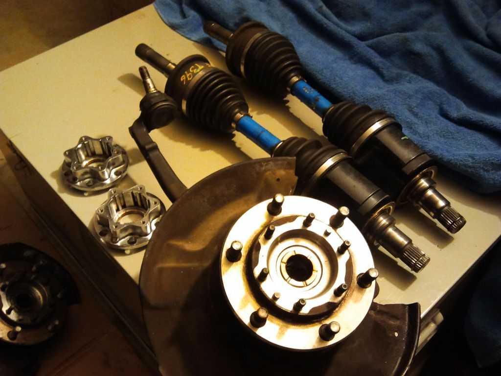

Here's a couple pictures of the rebuild and cleaning.
A before shot of the dial before I restore it.
Nearly cleaned up hub body... Off to the parts washer tomorrow.
The goods.
