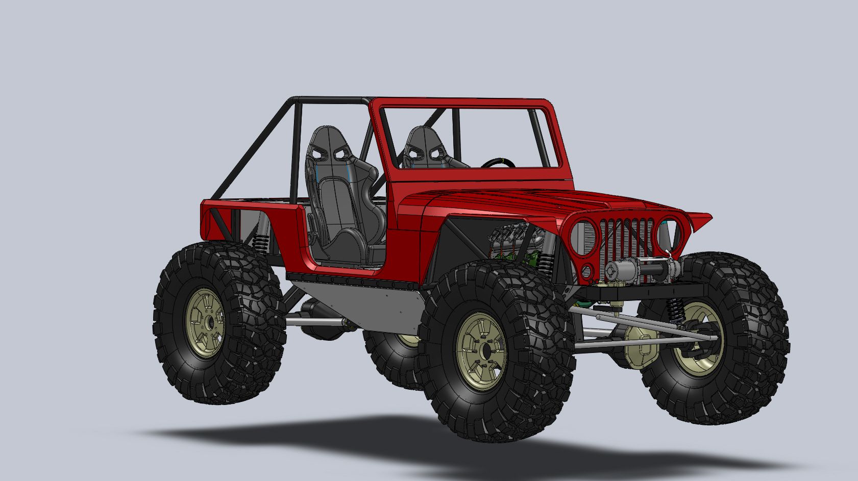

This is what I would build....
This is a 'buggy' I designed that has CJ7 skins 'hung' on the frame. It would allow the body to be easily replaced if it was to get damaged. I retained enough of the body to allow the factory windshield to be used along with any factory or aftermarket CJ7/YJ top. Quicky specs....
-LS based engine. There is enough room for a full truck trim engine with the deep pan and tall intake.
-Lots of transmission room,a 6L80 or 4l80 automatic will fit.
-Lots of transfer case room. An np205, atlas, or other aftermarket case will fit in drivers or passengers drop when clocked correctly. Most manuals will fit also.
-Full width axles work best with high backspacing wheels to keep overall width down to the 80-82" range.
-3-link front with a panhard and a real steering box ( with assist for the big tires )
-4 link rear
-12" travel coilovers front and rear, 6" uptravel from static ride height.
-109" wheelbase
-The chassis/body/suspension was designed around 42" tires with a 30+ degree steering angle.

Nothing will do all jobs at 100%, vehicle design is full of compromise....cost, complexity, size, etc.
I really enjoyed doing the UA trip in my flat fender. Any vehicle would be fun on that trip as long as it stays together and running.
I too am looking at building something a little more well rounded. For me, that has to include a way to have a windshield, wipers, defrost, top and doors. An open top vehicle really limits the climate you can use a vehicle. It might be fun to roar down the interstate in the rain or snow once...but it gets old. The balance with having those things is that the vehicle gets more sensitive to trail damage. I'm really trying to design something that is 'modular' in that respect where I can replace parts the get damaged without pulling my hair out. A guy can make just about anything once, but making it over and over might get a little more annoying.
Size is the big variable for most people. More and more people want to take kids, coolers, and camping gear in addition to all the normal stuff you should have with you anyways. Carrying that much stuff WHILE maintaining a very high level of off road performance is difficult. It's a very careful balance of overall size vs weight. A vehicle can only be so big before it starts to effect performance off road. Personally I think about a 110" wheelbase with a 40-42" tires at 80-82" wide overall is about right. The compromise is that the 'body' needs to be kept a bit smaller than most people will be happy with....
It's all a compromise...
