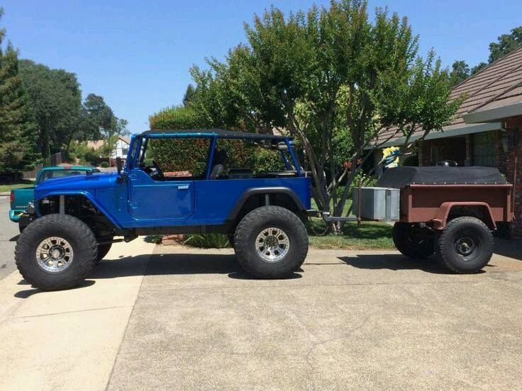

I'm really digging on the idea of using a factory FJ80 frame/link suspension with the Aqualu FJ40 stretch tub conversion. That looks like it could be a GREAT all around option.

Yup, the easiest is probably going to be a Jeep CJ/YJ or a FJ40 style land cruiser.
Ya I see this as the best place to start. If you found one with a title it's even easier. The fj build you linked to I like the way the frame was built. I started a fatty build that way 10 years ago.

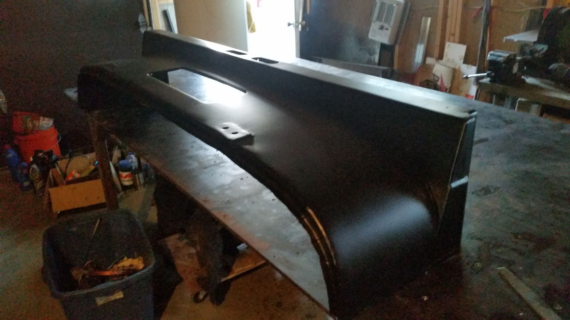

I chose the CJ/YJ cowl because its easy to get in a replacement part and allows me to bolt on the hood, windshield, etc. The body sides are also pretty easy to get in the YJ/7 length.
I designed the chassis so it could be one unit and all the body panels could bolt on....and be replaced.
