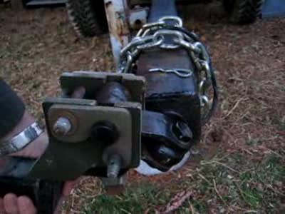

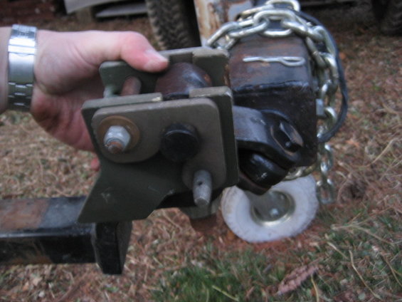

Here are a couple of pictures that I had lying around that show how the Lock-n-Roll binds. Again, I don't think that it's a big deal as long as you keep it in mind while driving, but I'm pretty certain, that if I had 5 trailers with these hitches, and got them to bind by turning them at 90 Deg and then pulled forward, that every one of them would break (at least bend to the point of needing a new one).
Straight:
Where it would start to bind:
Jack-knifed:
How it binds.. If you were to pull forward, it would bend, or break the hitch:
Here is a video of it:
Don
Here are a couple of pictures that I had lying around that show how the Lock-n-Roll binds. Again, I don't think that it's a big deal as long as you keep it in mind while driving, but I'm pretty certain, that if I had 5 trailers with these hitches, and got them to bind by turning them at 90 Deg and then pulled forward, that every one of them would break (at least bend to the point of needing a new one). Don
Great demo of a classic case of jack knifing.
You have reached 90°, the rotation has no where to go, so the movement goes upwards. Once the upward movement is halted the metal starts to twist.
Happens in ball couplers as well, I've done it.

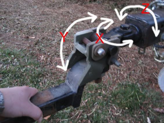

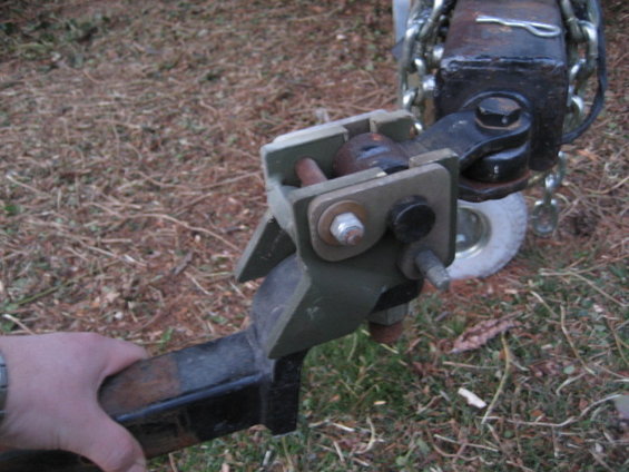

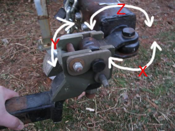

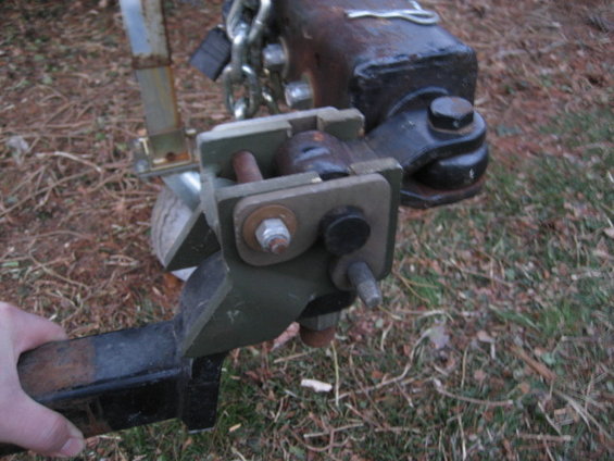

I am new here, but have noticed this thread as I am looking to get away from my standard ball coupler and go with a good offroad hitch. My friend has a lock-n-roll hitch and so far has had no problems. I will do my best to speak intelegently about this design.
While I do see the issue with jack knifing the trailer and the problem that it poses I have another scenario that might case the same problem with bending the hitch.
I will try to explain this the best I can so please try to follow me.
In the first photo I have shown the 3 axis that the hitch has, the second with the same axis just in different angle so maybe my explination doesn't loose anyone. The X axis allows the trailer to turn behind the vehicle, the Y axis allows the trailer to move up and down (as in going up and down a hill in a straight line), and the Z axis allows to trailer to tilt side to side independantly from the vehicle (or in striaght axle terms - Get all twisted up to the rig).

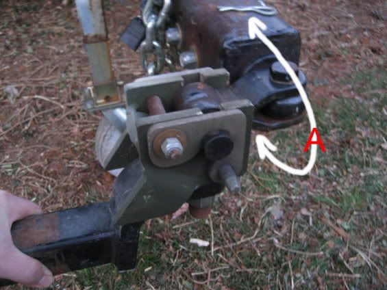

The problem I see other than just jack knifing the trailer and the hitch "collapsing" along the Y axis due to the play in the Z axis as it hits close to the 90* angle, If you are backing the trailer up (jack knifing the trailer) even before you get to 90 you could have issues if the trailer is going uphill as it turns behind the vehicle. Forcing the trailer to pivot on the A axis shown below, thus twisting/bending the hitch.

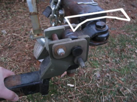

If the hitch were completely turned backwards and upside down it would solve that issue because the trailer would be allowed to pivot on the Y axis independent from the vehicle. However this does not solve the problem at a full 90* turn. I believe the hitch would still rotate on the Z axis and need to be lifted to unbind. I have an idea to solve the problem but would require some welding, but a plate welded with a moon shape cut in it to allow the hitch to still rotate on the Z axis to the hitch as shown below would keep the hitch from settling down once it hits the angle that allows the hitch to bind.
I will more than likely be buying one of these in the next week, So I will definitely do my modifications to the hitch to see if it works and report back.

This is where I think your misunderstanding Martyn... The angle doesn't need to get to 90 Deg. Only to about 75 Deg and it will start to rotate about the "Z" axis into a position that will bind IF, AND ONLY IF you try and pull forward. So it doesn't act like a ball mount in that respect.
There are a few solutions that I've thought of as well, but I just haven't had the any real problems with the hitch to warrant me digging into it.
And you are correct in your assessment of the hitch. It will start to get into a "bind" type situation around 75 Deg, and then get worse from there. It doesn't have to get all the way to 90 Deg. The weight of the tongue of the trailer is what pushed down and spins the "Z" axis. It doesn't need to be going uphill. It's fine as long as you don't try and pull forward. Most of the time, I will leave it in the "binding" position until I'm ready to leave, then I'll jack it up and pull forward letting it ride on the tongue jack wheel for a couple of feet and then stopping again and bringing up the tongue jack.
