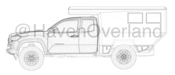

First Concept Drawing
The first thing that I noticed is that all of the top performers in the weight category either cut a bunch of the vehicle off to make way for a composite habitat or shed the bed tub to do the same. The Tacoma has a rather small payload capacity and as such every bit of weight shed from the factory curb weight would be a benefit so a bed replacement habitat seems like a no brainer for a purpose built overland vehicle like this.
Now we get into the nitty-gritty of the design process. I had already decided that this camper would replace the bed of the truck and that it needed to be built from composite materials. I’ve always appreciated how foam-cored composite panels add both structure and impressive strength to a build. The challenge, though, was aesthetics—most foam-core composite campers on the market look pretty boxy, and I just couldn’t bring myself to pair a sleek, modern truck with a generic square box. So, I dove into 3D design and began sketching a camper with intentional lines, angles, and curves—something that would actually complement the Tacoma’s styling, not fight against it.
Initial 3D renderings of the camper design.​
I may be biased, but I think the design I came up with really complements the look of the Tacoma. It maintains a similar overall exterior width to the stock truck bed, but thanks to the composite construction and integrated design, it offers an additional 6 to 8 inches of interior width on each side. That adds up to a total of 12 to 16 inches more interior living space—without compromising the truck’s footprint.
Another major advantage of an integrated camper is its ability to keep out dust and water. Traditional wedge-style or topper campers often struggle with sealing, especially around the bed of the truck. During our Baja trip, our previous setup let in a lot of dust—mostly because it's nearly impossible to fully seal the junctions between the camper and the truck bed, not to mention the tailgate and rear hatch. An integrated design, on the other hand, allows for continuous weather sealing—like using bulb seals around all doorways—which drastically reduces intrusion and creates a much more controlled interior environment.
