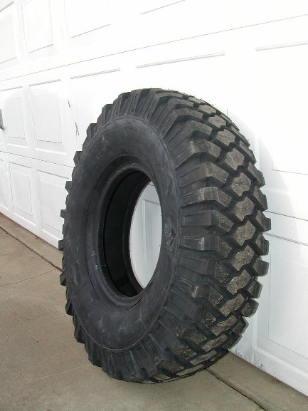

Wow, I'd love to see these on a Tacoma. They're huge though aren't they like a 36" tall tire?
It should be 34" or so.
A 9.0 R16 would break down like this
9.0 is the distance from the carcass tread to the bead, then you need to double is (half of the distance is below the rim, the other half on top), so 18"
Then, you need to add the rim diameter, which is 16"
9.0 + 9.0 + 16 = 34"
But, measured height and actual height can be very different. Has anyone here measured the 9.0 R 16 XZL?
You might be thinking of the 11 R 16 XZL, which is around 37-38" tall.
