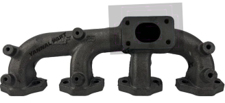

It looks like these industrial/forklift manifolds might have the right mating flange but fitment may be an issue as these orient the turbo upwards for the non-intercooled variant.
Yep, manifold looks about right on the engine. Rotate the cold side of the turbo so it faces down and run the pipe forward to the intercooler in front of the radiator. Use an intercooler from a FE73. The inlets and outlets tuck around the radiator just above the chassis.

Well I received the industrial manifold I posted about above and unfortunately it has a T2/T25 flange (I probably should have looked into the "25" cast into the manifold in the picture). Now I need to determine if I'll just get an adapter for the stock manifold or for the new one.

Here is the new manifold test fit. If the bolt pattern would have been correct it would have worked perfectly. I think I found the appropriate adapter for the T25 to T3 and it should only add 1" of offset (https://www.ebay.com/itm/1438197630...vX1ti5rHyxFa1i6DKbkN2ekY_fzPd_DLgBj7NeIhfWj1g)
The only thing that concerns me about this manifold is the inlet openings are a bit smaller and different shaped
That's what a die grinder is for... ;)
Installing that manifold as it is now would significantly affect gas flow and increase turbulence, which would likely affect the power gains you are looking for.
I have ported many heads/manifolds over the years; it's not that hard, but it can take a bit of time. Just make sure you are monitoring the wall thicknesses.
If wall thickness was going to be an issue on the manifold, adding a spacer plate between the head and the manifold would be another option, as you could deal with the shape transfers in that. You may also have to change the studs for longer ones, but that's a pretty simple task.
If I were going down that route I would laser cut the holes in the spacer to match the manifold, then grind out the opposite side to match the holes in the head.
That comparison picture makes it look a lot worse than it actually is. Here is a picture of where the stock gasket lines up. The mounting flanges are over 5/8" thick so there is plenty of meat to grind in a smooth transition. Whatever flow restriction the inlet ports might add I should make up for on the outlet. The outlet port on the stock manifold is (1.88 sq-in) vs the industrial one (2.23 sq-in) and then it will open up even more going into the HX30 T3 Flange. (3.65 sq-in)
1.88 sq-in, 2.23 sq-in, 3.65 sq-in.
