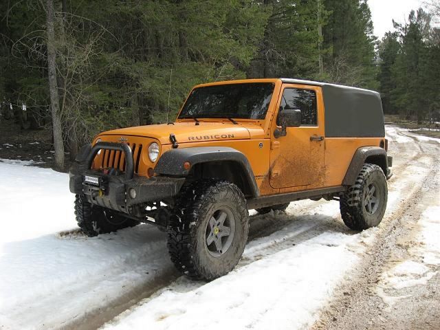

Just another quick 'chop, sorry to the guy on the AEV forum that posted the donor pic, but I really liked the stance and tire size.
This is a 4door base with the rear doors and top 'chopped out. 37" mtr/k tires on an AEV 3.5 lift. This is almost exactly the stance I am looking for. I think that is about the perfect compromise in my opinion. I think 37s are just about the most universal tire these days that can do just about anything but don't go overkill in any direction. That is subjective for sure, I run 39s on my daily driver :)
I hate it on most 4-doors, but I like a body colored top on this concept. The black top looks too much like a removable jeep top, where if its body color the theme blends better and looks more like a panel style vehicle or something?
To me the elimination of the rear doors and longer panel style top make the entire vehicle look shorter?
One more thing. On those vinyl wraps that cover windows how see-though are they from the inside? And how not see through from the outisde? I was thinking that could be a neat way to have a window in the top without it looking like it has a window? I like the clean panel side look but I can realize the advantage of having a window on the passenger side at least.
Just a few thoughts.
hope you don't mind me chopping the pic :) That's what you get for having such a nice looking rig!
How do you like the 3.5 AEV and 37s combo?
Chop away, sounds like you are coming up with a cool project. Love the Rango build by the way.
It is a 3.5" AEV lift with 37's. Really works well and after a little trimming and very slight modification, I have minimal rubbing. If you want to go with a tire that is any larger, don't get the AEV rear bumper though, as the tires make contact with the lower tube on the bumper at full flex.
