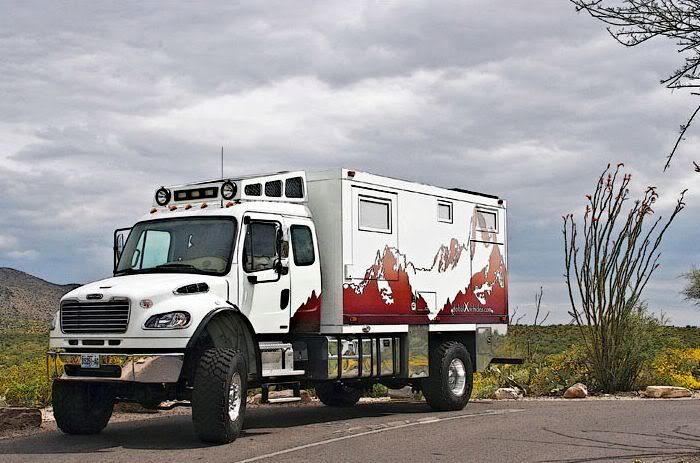

GXV has produced a PDF that has lots of information about the new "Patagonia" model, built on the Freightliner M2 chassis. Click here to request the brochure http://www.globalxvehicles.com/contact-us/
Here are some details about the truck chassis as built for the first Patagonia. There are many options available, such as a crew cab, 6x6 chassis, and so on.
2010 Freightliner M-2 106, 4x4
--Extended Cab (two doors)
--Overall length – 31', width – 8', height – 12' 8" (9448mm x 2438mm x 3860mm)
--GVWR – 33,000 lb
--Top highway speed: 85 mph (137kph)
--Wheelbase – 230" (5842 mm)
--Frame rails – heat treated alloy steel 120,000 lb psi, 11-1/8" x 3-9/16" x 7/16"
(282mm x 93mm x 11.1mm)
--Engine - Cummins ISC 315hp, 1000 lb-ft torque @ 1400 rpm
--Transmission - Allison 3000 HS, Automatic 6-speed / Overdrive
--Alternator - DR 12v, 160 amp, 28-SI Quadramount
--Air compressor – Cummins, 18.7 cf / min. with quick connects
--Transfer case – 2-speed, air shift
--All wheel drive, engageable
--Front axle - Single reduction, 12,000 lb
--Rear axle - Single reduction, 21,000 lb, axle ratio: 5.29
--Suspension – Airliner 23,000 lb. with snow chain clearance
--Brakes – Air Brakes with ABS
--Meritor main Driveline
--Air dryer – Meritor 1200 with heater
--Alcoa 22.5" aluminum wheels
--Michelin XZL 445/65, R22.5
--Fuel tanks – 300 gallons total (1135 liters). 2 @ 50 gallon and 2 @ 100 gallon
--Gasoline tank (for ATV/motorcycle) – 75 gallon (283 liters)
--Aluminum Roof Rack with 3-Soltek LED Driving Lights (2,880 lumens) and 2-Soltek HID Race Lights
(3,200 lumens)
--Winch – 16,500 pound Electric SuperWinch
--Heavy-Duty Off-Road Front Aluminum Bumper, Equipped for Winch, Black Powder Coat
--Heavy-Duty Aluminum Adjustable Rear Bumper– Black Powder Coat
--Spare Tire mounted on rear with manual hoist
--Extraction Mats mounted on rear, qty. 4

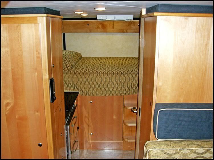

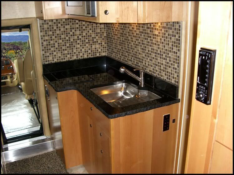

The galley, with pass-through to the truck cab visible in the background
The view in the other direction, showing the raised bed and storage

I noticed one discrepancy in the specs, though. It lists "Top highway speed: 85 mph (137kph)", but those tires are speed-limited to 60mph (source). It might be ok if they're lightly-loaded (which is likely given the load specs on those things), but definitely not officially ok.
Would the size of this vehicle cause problems on an "around the world" adventure? Seems it would be very limiting???
