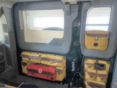

A friend sent me photos of window basket panels he installed on the rear doors of his Grenadier and I thought it was a good place to find some extra storage because you can't really see out of the bottom halves of the rear door windows anyway. But it seemed to me that with the combination of metal panels, plastic door panels and glass windows, anything you put in there would rattle unless is was in a cloth bag or some other soft wrap. And the metal panel installs with screws, which require making holes in the door panel:
Why not eliminate the metal panel and have bags that fit in the same location, so I designed bags that mount inside the recess around the windows and don't require screws, double-sided Velcro tape or any other fastening method that might damage the panel to secure them in place. To prove and test the design, I sewed one for the window in the small rear door. It mounts very securely without damaging the door panel and removes and leaves no trace that it was there. It's just a quick proof-of-concept prototype for testing; next I'll work on a bag for the wide rear door.

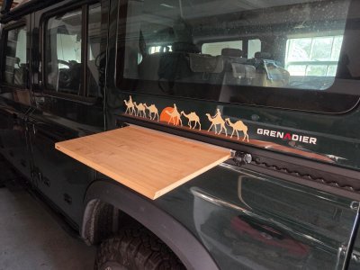

It's a simple side table which mounts to the Utility Belt. A mounting rail attaches to the Utility Belt with thumbscrews and a rail on the edge of the table that slips over the mounting rail. The mounting rail installs in seconds and can either be carried inside the vehicle until needed or it can be installed at the beginning of a trip for instant use:
For now I've left the mounting rail long; other things could be hung on the free ends but I may cut it just outside the thumbscrews.
The table slips onto the mounting rail:
The table is a $12.99 Ikea bamboo cutting board: https://www.ikea.com/us/en/p/aptitlig-cutting-board-bamboo-80233430/. A larger or different table could be used but for the price this one works nicely.

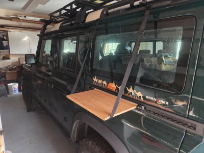

The table doesn't support too much weight with just the mounting hardware on the edge, so I added two supports made from webbing, they hook over the drip rail and are adjustable.

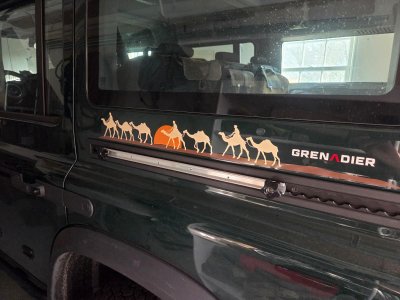

The mounting rail is a common extrusion used in the RV industry in the U.S. for mounting tables to walls. I found the piece I used on eBay, but here's an RV components supplier that carries it: https://www.rvupgradestore.com/AP-Products-013-164922-RV-Table-Wall-Mount-Support-p/20-3700.htm.
Both pieces have mounting holes and it turns out these are spaced properly for L-Track. I used L-Track studs I found on eBay: https://www.ebay.com/itm/365909329483 and all I had to do to fit the rail to the Utility Belt is drill out two of the holes with a 3/8" drill to fit the stud. I drill the holes that would be closest to the sides of the table board I was using and I didn't cut off the extra length of the rail in case I decided there was something else I wanted to hang there.
The table is a cutting board from Ikea (https://www.ikea.com/us/en/p/aptitlig-cutting-board-bamboo-80233430/). This board has angled sides so to mount the rail to it I trimmed one side to 90 degrees on the table saw. There are other boards at Ikea that don't have these angles sides if you don't have a way to trim the edge. I used 5 stainless steel wood screws to mount the rail, drilling a small pilot hole fo each screw to avoid splitting the wood. The 90-degree trimmed edge with the rail mounted, you can see the angled edge on the side of the board, the edge where the rail is attached was the same way before I trimmed it to 90 degrees.
The table needs supports for anything but the very lightest loads, so I made straps that use the drip rail for support. On one end of the strap is a hook to for the drip rail. This isn't the one I used, but they're available from many sources, here's one: https://www.strapworks.com/1-inch-stainless-steel-flat-hook. The hooks I had on hand are plastic-coated so they won't scratch the paint on the drip rail. A little bit of sewing it used to secure the hook and adjuster to the webbing. I also put a strap adjuster near that end. The drip rail end of the straps:
I put a snap socket on the other end and snap studs on the underside of each corner of the table. I used a snap stud with a screw mount, these are available at places like West Marine: https://www.westmarine.com/west-mar...ton-studs-with-tapping-screws-P008680084.html
Finished project:
Because I do a lot of sewing, I had all of the strap materials on hand for this project; the straps took me maybe 15 minutes to make and drilling the vehicle side rail and mounting the table side rail took maybe another 15 minutes, so this was a 30-minute project.
A few weeks ago I posted photos of a prototype rear window bag for the small door that I designed and sewed:
It mounts very securely without screws or double side tape; it doesn't damage the door in any way and it's easily removable.

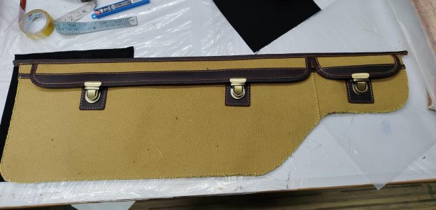

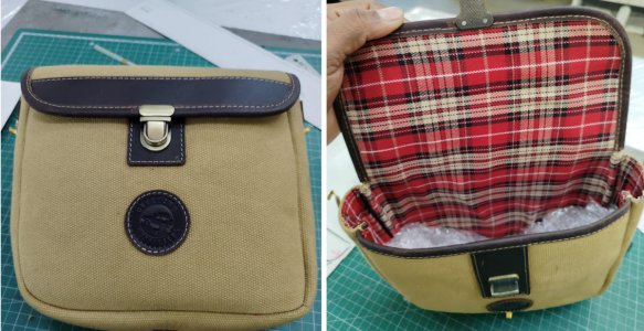

I sent my prototype to the craftsmen at Overland Outfitters. They sewed a preproduction sample and sent me these photos:
I had also sent them a pattern for a similar bag for the wide rear door. I took this photo as I was developing the pattern:

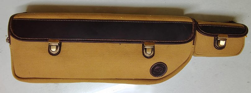

I didn't sew prototype of the wide version, I figured with the narrow sample in their hands and the pattern for the wide version they could sew one themselves. Which they are in the process of doing right now, they sent me this work-in-progress photo of the front panel for the wide one:
Once they finish the wide prototype they'll send me samples for testing, hopefully I'll have them by the end of the year. I'll post photos when I get the samples and test them.

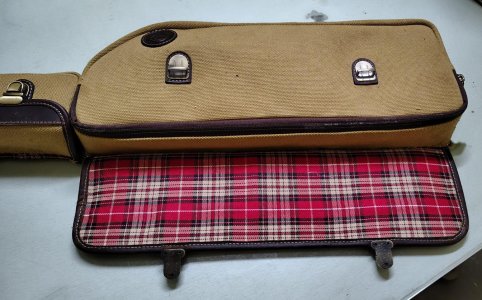

The craftsmen at Overland Outfitters sent me a few more photos of the wide rear door window bag preproduction sample in progress. They'll send me samples for testing, hopefully I'll have them around the end of the year.

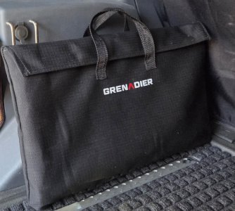

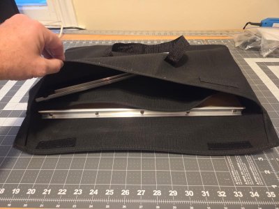

Two weeks ago I posted photos of a quick-mounting table for the Utility Belt that I made from an Ikea cutting board. I had finished the table and wrote that the next and final step was to make a storage bag for it so it wouldn't rattle around in the Grenadier when not in use. I sewed a bag for it yesterday.
There are two pockets inside, one for the tabletop and the other for the mounting rail and support straps.

For light use the table is self-supporting, but it's better to add the support straps for whatever load someone puts on the table:
