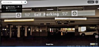

I stored two folding chairs and a small folding table under the cover on top of the tent, which increased my overall height to 8' 3". Everywhere I'm going on my trip for the next two weeks I'll be parking outside, so the height isn't a problem, except at the hotel I'm staying at in Las Vegas for the SEMA Show - there the Grenadier will be in a parking deck. So I used Google Maps Street View to check out the entrance to the parking deck. According to the sign I'll have 5" clearance. Always worth checking before finding out the hard way.

For this trip I added two folding chairs on top of the RTT/under the travel cover which raised my height to 8'3"; I'll be camping in Death Valley after the show, which is why I brought the roof top tent and chairs. I researched parking decks at Vegas Strip hotels using Google Maps Street View to see the entrances to the various parking decks and found one showing 8'8" clearance, and this one has good access to the monorail, so that's where I'm booked. Just fits.

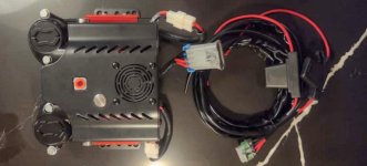

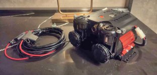

At SEMA this week I met with that compressor company and told them I was thinking of upgrading, and possibly doing on-board air in the Grenadier. So they gave me this one off their booth display:
It's a dual compressor, they tell me the specs are 5.9 CFM at 150 PSI with a 100% duty cycle. Pretty good specs. I'll have to see if it fits under the rear seat. I've got the factory dual battery option so there might not be enough room, in which case maybe I'll mount this in the Overland Outfitters bag.
