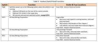

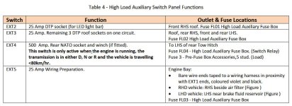

The photo above and the next two tables come from Rok_Dr’s Exceedingly Unofficial Owner’s Manual Supplement:
The standard switches/circuits:
None of those are on the roof. Some of the High Load switches are:
The power connections for EXT2 is on the front right side of the roof, and it's often used for lights that might be installed on a roof rack. My rack has lights mounted to it and that's the circuit I used for them.
There are three power connections for EXT3 on the roof - front left, right and left rear, all three are on the same circuit and switch.
One of those connections could be used for power in the RTT. Another good use of those connections would be for campsite lights. But since all three of those connections are on the same circuit, how do you provide power to the tent without also having the campsite lights on? Seems like another circuit would be a good idea if you wanted to do both campsite lights and power in the RTT and have independent control of each.
Also, all of the switches in both the standard and High Load panels are switched - meaning that when you shut off the ignition, power to those circuits is cut (except for EXT4, the 500a circuit intended for a winch). Typically you wouldn't have the ignition on while sitting around the campsite in the evening with the campsite lights on.
The Grenadier's solution to that is the PWR switch, also on the overhead panel. With the ignition off and that switch turned on, all internal and external switched circuits from the above tables, except EXT4 (500a winch power) are turned on. In addition, the optional USB ports on the rear of the center console get turned on and the optional 12v socket in the cargo area gets turned on. So if you use one of the circuits that requires that the PWR switch be turned on when the ignition is off, you would need to make sure that all of the other circuits that get turned on when the PWR switch is on aren't drawing unnecessary current.
